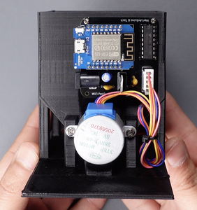

Step 2: 3D Parts and Assembly
The 3D design for the pet feeder includes three basic parts. The whole.stl in which the food is filled, the spiral screw.stl and cover.stl that allows the food to be pushed out. Download the STL files of the 3D models from the link below and print them with the help of a 3D printer.
For assembly, first the 608zz bearing is placed on the whole.stl, then the 28BYJ-48 stepper motor is placed on the bearing and fixed with two screws. In the next step, the spiral screw is placed the whole.stl inside to be fixed to the stepper motor end.

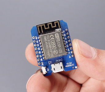

About the ESP8266 Wemos D1 Mini Board
The ESP8266 is a Wi-Fi module great for IoT and Home Automation projects. The ESP8266 is a Wi-Fi module. It allows you to control inputs and outputs as you would do with an Arduino, but it has Wi-Fi.
Wemos D1 mini is like a "little Arduino with wifi" for a great price. It's based around the ESP8266, has one analogue port and 11 digital ports. It's programmed via micro-USB (or remote flash via wifi). You can use it with the Arduino IDE.

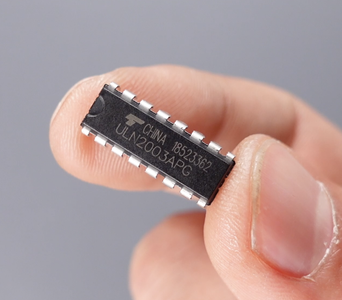

The power consumption of the motor is around 240mA. Because the motor draws too much power, it is best to power it directly from ULN2003 driver rather than drawing that power from the Wemos D1 Mini. The motor usually come with an ULN2003 based driver board which makes them super easy to use. The ULN2003 is one of the most common motor driver ICs.

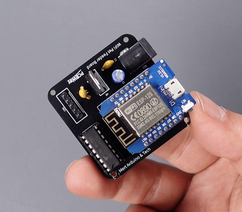

Step 4: Printed Circuit Board (PCB)
After testing the circuit, a PCB was designed to turn the project into a useful prototype. So I cleared the circuit from wiring complexity. To get the PCBs, upload the shared "Gerber" file to PCBWay and create the order. High-quality PCBs will arrive in a few days depending on the shipping address. Place and solder components according to reference (BOM) designator.
Get the Circuit Diagram and PCB Gerber file: https://www.pcbway.com/project/WiFi_Controlled_Pet_Feeder_ESP8266.html

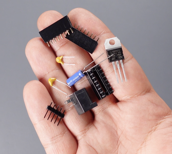

Required components for PCB prototype:
  • 1x 100uF Capacitor
  • 2x 100nF Capacitor
  • 1x B5B-XH-A (LF)(SN) Connector or Male Header
  • 1x DC005-2.0MM Jack
  • 1x L7805 Voltage Regulator
  • 1x ULN2003 Motor Driver IC
  • Female Header

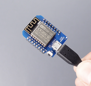

Two things are required when programming Wemos D1 Mini and similar boards with ESP8266 chip. You will need add-on to programming the ESP8266 with the Arduino IDE.
Open the shared source code with the Arduino IDE. First, install the ESP8266 add-on to program the Wemos D1 Mini.
File > Preferences. Enter the ESP8266 add-on URL into the “Additional Boards Manager URLs”
http://arduino.esp8266.com/stable/package_esp8266com_index.json
Go to Tools > Board > Boards Manager. Search the ESP8266 and install
Go to Tools > Board > Select the Wemos D1 Mini
