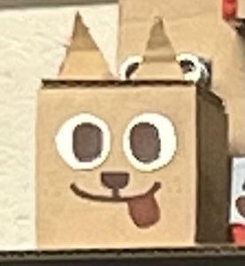

Introduction: Pet Pals (tamagotchi)
I made pet pal which is similar to what you can find in a tamagotchi and was the original inspiration for this project. I made “Pet Pals” more interactive, forcing the player to physically interact with the pet to keep it alive and happy.
“Pet Pals” has a variety of content to explore, such as a feeding mini game, playing mini game, sleeping and petting actions, as well as a decaying health bar.
Step 1: Pet Pal
We first need to make our actual Pet Pal. I’ve made by Pet Pal into a dog but you can do any pet based on your preference. Don't forget to decorate it!
Keep the back of the pal empty so you can add a servo which will to a piece of cardboard sticking acting as a tail. This tail (servo) will be later coded to wag when you successfully take care of the pet or any other actions. This gives the pet much more life, making it feel real.
Step 2: Happiness Meter
This is your pet’s happiness meter. The point of this contraption is to display the happiness of your pet at all times. For our game to have any purpose, this servo will very slowly keep moving making its way to the far right indicating your pet’s death.
Through coding, we will make it so that winning a mini-game, petting, or putting your pet to sleep will increase this bar towards to the left (indicated by the heart). This mechanism will prompt the user to play a game or care for the pet in order to keep it alive and to the left half of the happiness meter.
