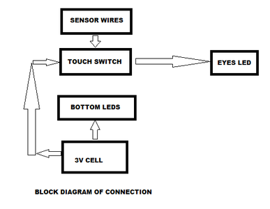

Step 3: Block Diagram
To make this Tortoise, I divided the electronics into 2 main parts. One for the Base/Bottom LED's and second for the touch switch. Both get power supply from a single 3V cell which is connected in parallel. The two parts are as explained in below steps.

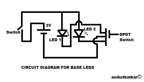

Step 4: Making the Base
The base part includes two LED's to give the neon effect as shown in the photo. The two LED's are a superbright green LED and a RGB blinking LED which changes color with time.
The circuit is as shown in the photo above. You can use any other color LED and can connect the circuit as you wish keeping in mind the end result remains the same.
One switch is a normal toggle switch to switch the whole circuit ON/OFF. While the other switch is a DPDT switch used to switch which LED is used Green or RGB. Only one LED can remain ON at a time.
You can add an additional switch to decide to keep the touch switch ON or OFF. Such a configuration makes sure the Cell used lasts for more time.

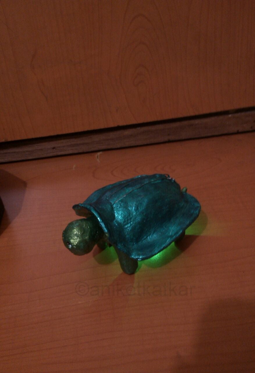

Now we have almost built the whole thing. Check everything from base LED's to the touch eyes LED. The Green an the RGB LED should be working. The eyes LED should glow when you touch the wires as shown in photos.

Final part is coloring the tortoise. Paint as per your wish. I have painted the shell with acrylic light green and the body with dark green. You can also get texture on the shell to make it more attractive.
Bend the touch wires on the shell which were out. Take small amount of clay to attach the other end of the wires to the shell. Do not color on the wire.
Step 12: Finalising
Now the coloring and electronics is done. Do some final touches and wrap the gift for your special ones. It looks good on your shelf and you can even use it as a paper weight. Your own personal Pet Tortoise :)
