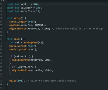

Step 3: The Code
I simplified the code after I tried to use the code from TinkerCad to run the circuit. The calibration variables are valAir and valWater. You can calibrate the water sensor to trigger the output voltage by alternately submerging the sensor in water and exposing it to air. When you do so, you can read the values in the serial monitor of this program: Arduino IDE. Then you can alter the values easily in the code to calibrate the water sensor. Also, note that the output voltage is set to leave pin 13 on the Arduino and the water sensor is wired into pin A5.
