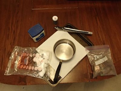

Step 1: The Hardware
You'll need:
- Permission or supervision, if required
- A small saucepan
- 6-10 cotton balls, no synthetics. Some have opted to use makeup removing pads. As long as they're cotton, I've got no gripe. You'll end up with more fire for less time, which may serve you better under conditions.
- 1/4 c or more petroleum jelly
- Tongs
- Paper towels
- Baking sheet
- Stove
- Pill bottle
Arrange this stuff in a work station near #8. Everything else should be at hand besides #9. It will and should wait. You'll see why.
Edit: That bag in the lower right hand corner is my fire starting system. It has two lighters and a dozen squares of birch bark. With these fire starters, I have plenty of time to get quite a fire going, and without more fuel, probably just enough to get a liter of water to a simmer. With two lighters, I have them. It's a good idea to 'candle' your lighters; use your headlamp to provide back-light and determine the level of fuel in them. Farmers 'candle' eggs to see if they're food eggs or embryonic. You'll do it to see if your lighters will save your butt in a pinch.
