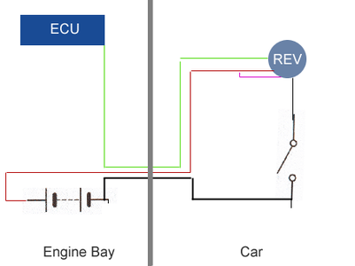

Step 2: Wire Diagram
The diagram below shows the wiring of the rev counter to the ECU. Check your haynes manual for the right pin to connect it to. For mine it was pin 6 (I have the mk 1)
CAUTION1: I recommend that you put a diode on the signal wire to prevent back current.
CAUTION2: This can also be done to the cars coil pack which is safer! However this gave me incorrect readings so I used the ECU
Red wire: This is the live wire to your battery.
Purple Wire: This is the switch wire; this is traditionally connected to your ignition to turn the counter on when the ignition is started. I soldered this to the primary live.
Green Wire: This is the signal wire that runs from the counter to the ecu. On the peuegot 106 its pin 6 (check your haynes as the 106 has may different ECU'S) this is a mk1.
Black Wire: This is the earth wire for the system.
