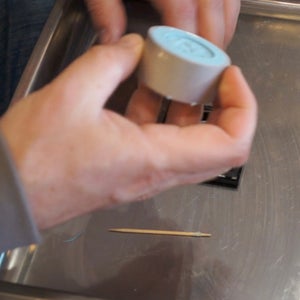

Step 4: Cotton Putty Front
The Cotton Putty is just something I found at my toy store. It will probably work with any kind of kinetic sand, but this works great.
Put the metal ring in the outer ring.
Pack in the Cotton Putty with force to be sure that it ends up in all the holes of your design.
Remove the metal ring with the Cotton Putty from the design. -This is a kind of an art. If you move to slow the Putty will stick to the design and if you move to fast you'll probably smutch the design.-
Step 5: Cotton Putty Back
Pack the Cotton Putty in the back not all the way full, but leave a dimple in the middle.
Use a straw to make a hole in the middle of the dimple trough the Cotton Putty to the coin design.
Remove the metal ring with the Cotton Putty carefully from the design.
Use a toothpick or something to make some small air channels from the cavity in the Cotton Putty to the edge of the metal ring.
Join the two metal rings together. (sometimes I use masking tape to keep them together)
Step 6: Pouring the Cast
Put the mold with the dimpled site up in a fire proof tray.
Melt some pewter in an old pot on the stove. (I got my pewter from a garage sale)
BE VERY CAREFUL WHEN WORKING WITH MOLTEN METAL!!!
Pour the molten pewter in the dimple in the Cotton Putty.
Wait until the pewter is cooled down.
Step 7: Clean Up the Cast
I never wait long enough to not burn my fingers, that is because the pain of waiting is worse than the pain of burning my fingers.
Remove the coin from the mold.
Clean off the Cotton Putty.
Use snippers to cut off the worst of the sprew and overspill.
Use a file or belt-sander to clean off the rest of the sprew.
Step 8: Paint
To improve the contrast and make the coins more look like old pirate coins, I weathered them with acrylic paint.
Use a brush to fully paint them in a dark color.
Use a cloth to try to fully wipe them clean again.
The paint will remain in the low spots, while the high spots will be clean and shiny.
