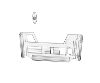

- 3D Print "frame and nano holder and horn"

Step 2: Print the Frame and the Nano Box
I Printed these items separately and glued the box on after wards.
This was printed with PETG with a 50% infill to give it more sturdiness.
The frame fits snugly over the standard landing gear this design is not flawless but it does the job.
