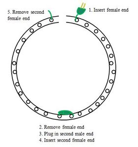

Step 5: Put Lights in the Middle Ring
Putting the lights inside the irrigation tubing and the PVC candles is an excellent way to hide them, and lets you use ordinary Christmas lights for lighting, but it is far from easy. First, thread string through the inside of the ring, using a small weight on the end to pull it through. The most important this is that the you insert the string and pull it out not in the end of the tubing, but in the first candle hole. If the lights and in the very end of the tube, you won’t be able to connect the two end to each other in a ring. If you end up with extra lights coming out of the tube, you may have to redo the whole thing. Also, be warned that it will be really hard to pull all the lights through. You may want to tape all the ­­lights down with masking tape before you start, or trim off the plug on one end (safely), to prevent them from getting stuck in the tubing. Everyone will have to do this differently, though, depending on the length of the strands of lights they’re using. If you’re using more than one strand, it will get exponentially more difficult, but this is likely considering that the full length of lights you will need, which, because each strand goes up twice into each candle (see Step 12), is about three times the length of the tubing itself. If you do need to use more than one strand, remember that you probably can’t pull the male end plug through due to its obnoxious girth (I successfully pulled through the female end plug, but only after filing down the plastic on the outside). If you’re using multiple strings of lights, your process may look more like the picture at the beginning of this section.

Lower the chandelier so that the middle ring is resting on the ground. Starting at the end of your strand of lights, (not where they are coming out of the tube – the other end), pull five lights up through each hole, fold the resultant wire against itself so that the middle light is sticking up on the top, and stuff this into a PVC candle. Plop a gold cup over the candle, hot glue the cup to the irrigation tubing and the PVC to the cup. Generally get a lot of hot glue in the center of the cup and make sure everything is secure to each other – it’s not like anyone will see inside there anyway. Repeat this for all 30+ candles, or until you go insane from the tediously difficult task of stuffing lights in PVC. After all this, take any extra wire and run it up a nearby chain to the top ring (attach with zip-ties). Feel free to spray paint this gold as well, and cover up any unintentionally exposed lights with gaff tape.
