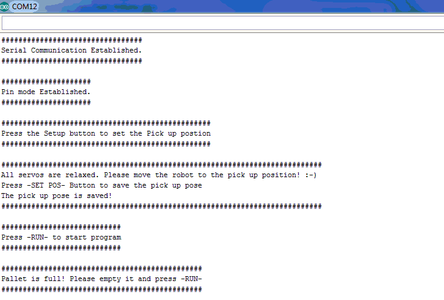

Step 4: Getting Started With the Robot
When the arduino program file has been uploaded open the serial monitor. (before 6 seconds after upload, because of a delay made in the arduino program)
A guide will now show on the screen and tell the user what to do step by step.. See the image example file.
Getting started without serial monitor - Step by Step
1. wait for the LED on output "D3" to turn on - this means that the arduino board communication and setup is ready
2. Press the Relax button on input "D0" - this will relax all servos and enable the possibility to adjust the gripper at the potentiometer.
3. Now move the robot manually to the position where the pick up should be. the gripper should be adjusted to squeeze tight around the object.
4. Press the "Set pos" button when the robot is in place. This will open the gripper and save all positions for the servo.
5. When ready press the "RUN" button and make sure that the robot is always handed new items to move.
6. When there is placed 2 blue objects and 2 green the robot will stop. It is possible to run the program as many times as you like. Simply just press "RUN" again. - remember to remove the old objects from the drop off positions.
