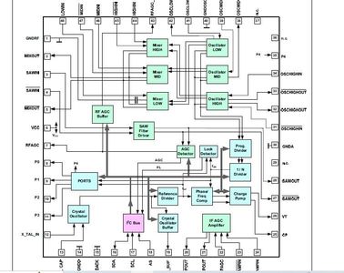

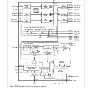

A phase-locked loop (PLL) is a control system that generates an output signal with a phase related to the phase of an input signal. PLLs are electronic circuits that constantly adjust to match the frequency of an input
I did an Instructables project before for PLL in great detail.
this new project is about a new software driver for a PLL IC chip, that has been used in an analog TV tuner.
with a good antenna and analog TV tuner, you can listen to FM radio, truck driver's radio, and any emergency services in your area that use FM analog transmission, because the analog TV tuner has a 3-band mixer/oscillator and PLL for
terrestrial tuners. that is capable of operating from 40MHZ to 1GHZ RF frequency
by knowing the channel frequency you want to listen to, you can select the right band and frequency.
any Arduino board will do, PLL uses I2C.
datasheet for different analog TV tuner PLL IC chip
