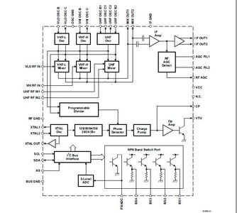

1.The SN761662 is a low-phase-noise synthesized
tuner IC designed for digital TV tuning systems. The
circuit consists of a PLL synthesizer, three-band local
oscillator and mixer, 30-V output tuning amplifier, four
NPN band-switch drivers, and is available in a
small-outline package. A 15-bit programmable
counter and reference divider are controlled by I2C
bus protocol. Tuning step frequency is selectable by
this reference divider ratio for a crystal oscillator.

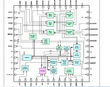

2. The TDA6508A This device is a programmable 3-band mixer oscillator and
synthesizer intended for LOW, MID, and HIGH band TV
and VCR tuners. It has three double-balanced mixers and
three oscillators for the LOW, MID, and HIGH band
respectively, a PLL synthesizer, and an IF amplifier.

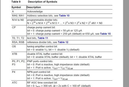

3. The TUA 6039F-2, TUA 6037F device combines a mixer-oscillator function and an IF
AGC amplifier with a digitally programmable phase locked loop (PLL) for use in analog
and digital terrestrial applications.
1.SN761662 DTV Tuner consist of a PLL synthesizer, three-band local oscillator and mixer with a digitally programmable phase locked loop (PLL) for digital tv tuning systems.
2.TDA6508A 3-band mixer/oscillator and synthesizer with a digitally programmable phase locked loop (PLL) for terrestrial tuners.
3.The TUA 6039F-2, device combines a mixer-oscillator function and an IF

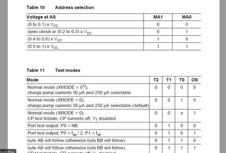

Step 4: Programming the SN761662DBTR Digital TV Tuner
oscillator, and mixer, 30-V output tuning amplifier, four
bus protocol. Tuning step frequency is selectable.

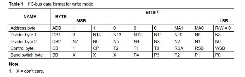

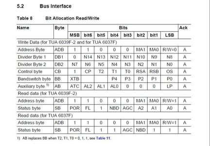

The first byte (ADB) is for the slave address
The second byte (DB1) is for the programmable divider bits.
The third byte (DB2) is for the programmable divider bits.
The fourth byte (CB1) is for the charge-pump current control the reference divider ratio and the weak signal booster control.
The fifth byte (BB) is for the band switch.
The six bytes (CB2) are for the RF AGC start point.
Example I2C Data Write Sequences
Telegram examples:
Start-ADB-DB1-DB2-CB1-BB-CB2-Stop
Start-ADB-DB1-DB2-Stop
Start-ADB-CB1-BB-CB2-Stop
Start-ADB-CB1-BB-Stop
Start-ADB-CB2-Stop
Abbreviations:
ADB: Address byte
BB: Band-switch byte
CB1: Control byte 1
CB2: Control byte 2
DB1: Divider byte 1
DB2: Divider byte 2
Start: Start condition
Stop: Stop condition
For the SN761662 DTV tuner, I2C-bus, Six data bytes are required to program the device fully
.Example:
.If we need to tune to channel number 27
S = START, A = acknowledge, and P = STOP. The sequence is as follows:
START + address byte + divider byte 1 + divider byte 2 + control byte + band switch byte + Test bits/XTALOUT control STOP.

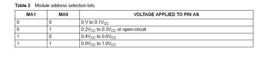

1. The first byte is the device address, (ADB)0b11000000 or 0xC0 in the datasheet, but because of the I2C library in Arduino the address gets shifted so it will be 0x60 Wire.beginTransmission(0x60);
2. The second byte(DB1) is the programmable divider, 16348+8192+4096+2048+1024+512+256
 Wire.write(0x2B); the first (DB1) it will be 0b00101011 or 0x2B
3. The third byte(DB2) is the programmable divider,128+64+32+16+8+4+2+1+0
uint16_t data =11080; fpd = data; Wire.write(fpd & 0x00FF);
11080 to binary =0b0010101101001000 = the second (BD2) it will be 0b01001000 or 0x48

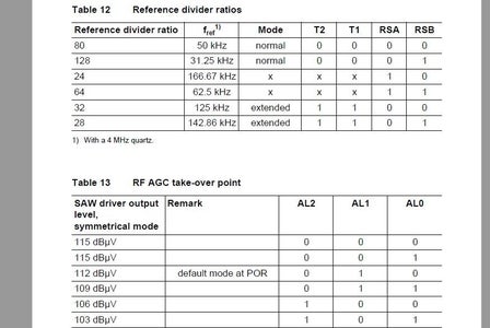

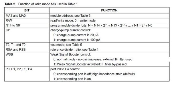

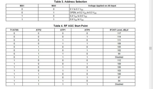

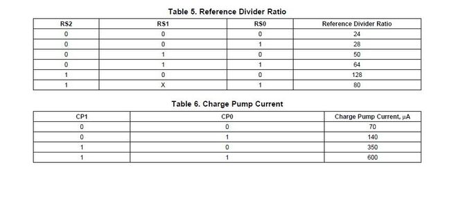

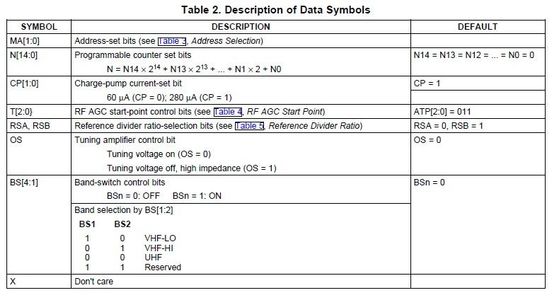

4. The fourth byte is the control byte:

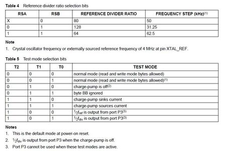

.bit numbers 1 2 and 3 are for reference divider ratio (RS0, RS1,RS2)
, bit numbers 4 5, and 6 for RF AGC Start point
.bit numbers 7 and 8 for charge-pump current
In my case, I set the RS0=0 RS1=1, and RS2=0 and the reference divider ratio set to 80 which means it will divide the Crystal oscillator frequency or externally sourced reference frequency of 4 MHz at pin XTAL_REF 4000000 / 80 = 50000 KHZ
5. The fifth byte is for band switch
  • bit BS1 enables port P0 (20 mA drain current) and the LOW band mixer/oscillator
  • bit BS2 enables port P1 (20 mA drain current) and the MID band mixer/oscillator
  • when BS1 and BS2 are both set to 0 (disabled) the HIGH band mixer/oscillator is enabled
  • bit p2 enables port p2 general use
  • bit p3 enables port p3 general use
  • bit p4 enables port p4 ADC use

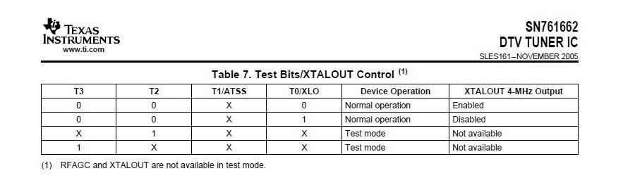

6. The byte number six is for Test bits/XTALOUT control

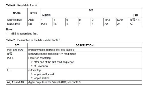

   Wire.requestFrom(0x61,1); //in-lock flag (FL = 1 when the loop is phase-locked)
   while (Wire.available())
int lockst = Wire.read();

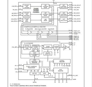

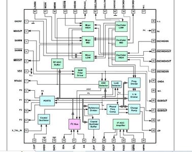

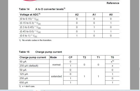

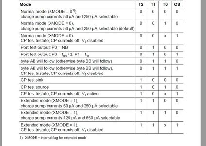

Step 5: Programming the TDA6508A Analog TV Tuner
GENERAL DESCRIPTION
synthesizer intended for LOW, MID, and HIGH-band TV
respectively, a PLL synthesizer, and an IF amplifier. There
are four package variants: TDA6508, TDA6509,
TDA6508A and TDA6509A. Versions TDA6508; TDA6509
have a symmetrical IF amplifier; versions TDA6508A;
TDA6509A has an asymmetrical IF amplifier, (see Fig.1).
The common output of all three mixers can be connected,
via two output pins, to an external IF filter to enable
shunted IF bandpass and serial filtering for improved
signal handling. Two input pins are available for
connecting the output of the external filter to the input of
the IF amplifier. The mixer output has an impedance
of 300 W. The IF amplifier input has an impedance
of 2.5 kW (5 pF).

The PLL synthesizer comprises a 15-bit programmable
divider, a crystal oscillator, a programmable reference
divider, a phase comparator (phase/frequency detector)
combined with a charge pump which drives an internal
tuning amplifier and an output at pin CP. The CP signal
current can be integrated by connecting an external RC
loop filter between pin CP and pin VTUNE as shown in
Fig.27. The tuning amplifier can supply up to 33 V (max.)
at pin VT for controlling any of the internal oscillators via
external tank circuits. The phase comparator can operate
at 62.5, 50, or 31.25 kHz with a 4 MHz crystal, depending
on the reference divider ratio of either 64, 80, or 128; see
Table 4. An externally sourced signal having a frequency
between 3.58 MHz and 4.43 MHz can be used as a
reference frequency for the internal crystal oscillator at any
of the reference divider ratios.
In test mode, port P3 will output either half the crystal
reference frequency (1¤2fref) or half the reference divider
frequency (1¤2fdiv); see Table 5.
The device can be controlled according to the I2C bus
format; see Table 1. The in-lock flag bit FL is set to logic 1
when the PLL is locked. This flag is read from the status
byte on pin SDA during a READ operation; see Table 6
and Table 7 in the data sheet.
For the TDA6508A analog TV tuner, I2C-bus, five data bytes are required to program the device fully
.Example:
.If we need to tune in to FM 101.1 WRR FM radio, the setting for the PLL will be:
START + address byte + divider byte 1 + divider byte 2 + control byte + band switch byte + STOP.
1. The first byte is the device address, (ADB)0b11000010 or 0xC2 in the datasheet, but because of the I2C library in Arduino the address gets shifted so it will be 0x61 Wire.beginTransmission(0x61);
2. The second byte(DB1) is the programmable divider,16348+8192+4096+2048+1024+512+256
uint16_t data =2022; fpd = data; Wire.write(fpd >> 8); 2022 to binary =0b0000011111100110 >>8 = the first (DB1) it will be 0b00000111 or 0x07
3. The third byte(DB2) is the programmable divider128+64+32+16+8+4+2+1+0,
uint16_t data =2022; fpd = data; Wire.write(fpd & 0x00FF);
2022 to binary =0b0000011111100110 & 0x00FF = the second (BD2) it will be 0b11100110 or 0xE6
  • bit number 1 is for weak signal booster control
0: normal mode - no gain increase: external IF filter used
1: Weak Signal Booster activated: IF filter by-passed
  • bit numbers 2 and 3 are for reference divider ratio (RSA, RSB)
In my case, I set the RSA =0 and RSB =0 the reference divider ratio set to 80 which means it will divide the Crystal oscillator frequency or externally sourced reference frequency of 4 MHz at pin XTAL_REF 4000000 / 80 = 50000 KHZ
  • bit p0 enables port P0 (20 mA drain current) and the LOW band mixer/oscillator
  • bit p1 enables port P1 (20 mA drain current) and the MID band mixer/oscillator
  • when p0 and p1 are both set to 0 (disabled) the HIGH band mixer/oscillator is enabled
.as you can see the (DB1)=0b00000111, and (DB2)=0b11100110,
Fref and Fdiv going into the phase comparator will tune to channel 101.1 FM WRR classical music channel.
Step 6: Programming the TUA6039F Digital and Analog TV Tuner
The TUA 6039F-2, TUA 6037F ’OmniTune™TUA 6039F-2, OmniTune™TUA 6037F’
the device combines a mixer-oscillator block with a digitally programmable phase-locked
loop (PLL) and a variable gain IF AGC amplifier for use in TV and VCR tuners, set-top box
and mobile applications. Integrated narrow-band RF AGC functions with output
buffer is provided.
The mixer-oscillator block includes three balanced mixers (one mixer with an
unbalanced high-impedance input and two mixers with a balanced low-impedance
input), two 2-pin asymmetrical oscillators for the LOW and the MID band, and one 4-pin
symmetrical oscillator for the HIGH band, a reference voltage, and a band switch. The
mixer output signal passes a SAW filter driver and an IF AGC amplifier to provide
constant output level ready for A/D sampling.
The PLL block with four-pin programmable chip addresses forms a digitally
programmable phase locked loop. With a 4 MHz quartz crystal, the PLL permits precise
setting of the frequency of the tuner oscillator up to 1024 MHz in increments of 31.25,
50, 62.5, 125, 142.86 or 166.7 kHz. A microprocessor controls the tuning process
via an I2C bus. A flag is set when the loop is locked. The lock flag can be read by the
processor via the I2C bus. The device has 5 output ports and an X_TAL output buffer. One
of the ports (P4) can also be used as input for a 5-level A to D converter (only available
in TUA 6039F-2).

• 6 programmable reference divider ratios (24, 28, 32, 64, 80, 128)
• 4 programmable charge pump currents
For the TUA6039F DTV tuner, I2C-bus, Six data bytes are required to fully program the device
.Example:
START + address byte + divider byte 1 + divider byte 2 + control byte + band switch byte + Auxiliary+ STOP.
uint16_t data =1818; fpd = data;  Wire.write(fpd >> 8);
1818 to binary =0b0000011100011010 >>8 = the first (DB1) it will be 0b00000111 or 0x07
uint16_t data =1818; fpd = data;  Wire.write(fpd & 0x00FF);
1818 to binary =0b0000011100011010 & 0x00FF = the second (BD2) it will be 0b00011010 or 0x1A
  • bit number 1 is for tuning amplifier control
  • bit 4 5 and 6 are for test bit
  • bit 6 7 and 8 for charge pump control
  • bit p0 enables port P0 and the LOW band mixer/oscillator
  • bit p1 enables port P1 and the MID band mixer/oscillator
6. the byte number six is for Auxiliary
.as you can see the (DB1)=0b00000111, and (DB2)=0b00011010
Fref and Fdiv going into the phase comparator will tune to channel 90.9 KCBI FM radio channel.
