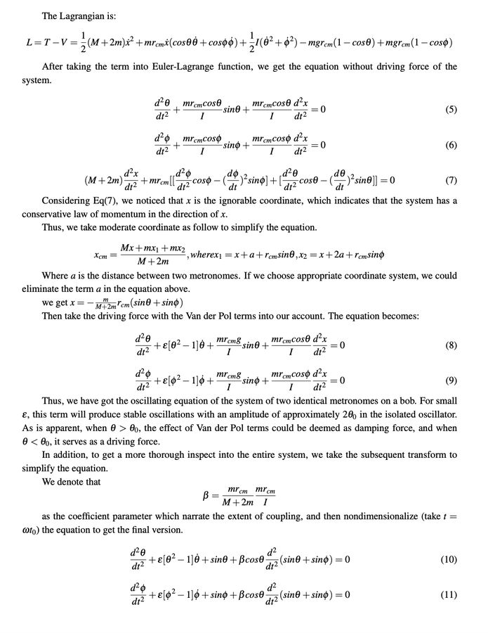

Step 3: Qualitative and Mathematical Analysis
If the intuitive explanations do not make sense, here are some mathematical equations. I am going to cite Xuepeng Wang’s paper on coupled metronomes as the equations get a bit complicated and confusing.
His paper: https://arxiv.org/pdf/1805.00416.pdf

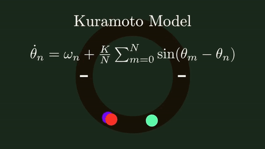

Time synchronization isn’t just a phenomenon that occurs with just coupled metronomes or coupled pendulums, it actually occurs every single day in our lives. Let’s start from the foundation of synchronization, the Kuramoto Model.
Before I explain the Kuramoto Model, I want to display the concept of it before showing the complex equation that may seem a bit overwhelming. Let’s take a system of two metronomes:
Step 5: Kuramoto Mode

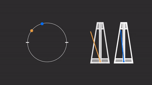

Above, you can see an animation that displays the motion of one metronome. We can represent this motion as circular motion. We can set the starting point as 0 degrees, and each time the metronome ticks, or reaches one side, it will have “rotated” or moved 180 degrees, which is half a circle, and when it hits the other side and ticks, then it will have “rotated” or moved 360 degrees, which is a full circular rotation, and is back to 0 degrees. If we increase the frequency of the metronome, then the dot will move faster in the circle. Now, let's consider a system of two metronomes with this representation. In the next animation, it can be seen that the two metronome dots rotating are not in sync as the metronomes are not in sync and have different frequencies. The second animation depicts two metronomes with the same frequency, but are not in phase. This specific animation is two metronomes that are in antiphase as if they were in phase, the dots would be moving together as one.
Now that we have this knowledge, we can analyze the Kuramoto model. From this previous example, we can use this information to create an intuitive explanation for the Kuramoto model with the use of the dots rotating in a circle. It says that the rate that each dot goes around the circle equals its natural frequency plus a certain amount of how far it is from the other dot, which is determined by the coupling strength, K. (Depicted in third animation)
A better explanation for this model goes like this: Imagine you're running with some of your friends on a circular track, but maybe one of your friends is faster than you and another slower. The speed of how fast each individual is your natural frequency. Now, let’s say your faster friend tells you and your slower friend to speed up, and if they are willing to go a bit slower while you and your other friend decide to speed up, all of you will eventually run at the same pace with each other. This push by your other friend is the certain amount of how far you are to the other “dots”, or friends in this case and is the second part of the Kuramoto model. However, the coupling strength can be described as how strong your friendship is with one another. If you're not very good friends with one another, synchronization will never occur as your “coupling strength” is too weak, which is the letter K in the equation. (Depicted in fourth animation)

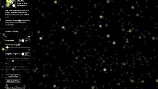

The fireflies of Southeast Asia are able to flash their lights together even though individually, they all flash at their own frequencies and there are thousands of them, yet they are somehow able to synchronize their flashes of light together. This is due to how strong their coupling strength is to each other. Based on the Kuramoto model, this means that each firefly would have an effect on every single other firefly. I want to reference a simulation that I found online that perfectly demonstrates the coupling of fireflies flashing: https://ncase.me/fireflies/
In this simulation, if you switch on the option to nudge neighbors, the fireflies will begin to start flashing together, and eventually, it can be seen that the fireflies will all sync their flashes together at the end. If we increase the slide to make the nudges, we are increasing the coupling strength, causing a much more synchronized pattern for the fireflies. Time synchronization is easily explained by the Kuramoto model in this case since in the simulation and in real life, the coupling strength of the fireflies is strong enough for a synchronized flashing of each flies light.
