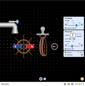

Using the generator simulation on the PhET simulation platform, the project explored energy conversion and power generation. It illustrated the operation of turbines and the transformation of mechanical energy into electrical energy. A greater comprehension of generator science was made possible by the simulation's ability to simulate experiments using turbines, magnets, and circuits. In addition to sharing the experience, the instruction manual builds and tests the generator in the simulation and gives detailed directions on how to repeat the experiment. Students, teachers, and do-it-yourselfers can all benefit from this guide, which explains the principles of electricity generation and how to use them in practical situations.

In real-world generations, hydropower, wind, or solar are used to drive turbines, which convert their mechanical energy to electrical energy. In the simulation, the water faucet and wheel represent a hydroelectric turbine; as the water flows, it spins the wheel and rotates the bar magnet inside the coil, including electricity.

Electromagnetic Induction
Component: rotating bar magnet and coil
Faraday's law of electromagnetic induction states that a changing magnetic field induces a current in a wire coil. In a simulation, a bar magnet spins, causing electrons to flow through the coil, generating electricity. Faster rotation increases the induced voltage, making light bulbs brighter. This principle is the core principle behind power plants like wind turbines and hydroelectric dams.

Step 1:
Open the PhET website and search for the "Generator" simulation
Step 2:
Explore the different components available, such as the Bar Magnet, Pickup Coil, Loops, Electrons, Compas, water, and whatever else. The bar magnet represents the magnetic field source, which can be adjusted using a slider. The pickup coil is where electromagnetic induction occurs, with loops affecting the induced voltage. Electrons show the movement of electric charge in the circuit, while a compass displays the direction of the magnetic field. A field meter measures the strength of the magnetic field at a specific point.
Step 3:
Now that you're familiar with the components, it's time to start experimenting with the magnetic field and observe how it affects the coil. You can use the slider to change the strength, adjust the number of loops, change the loop area, and watch the electrons in the coil to see if they start moving or change. Test the different configurations to maximize the generators' efficiency.
