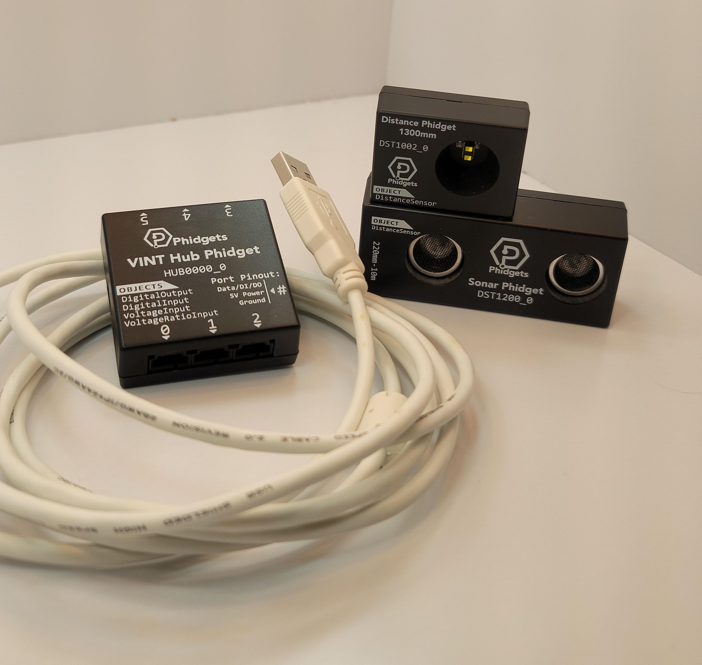

Now that our Pi is configured we will need to connect our Phidgets. Start by connecting your Phidgets Plug to the VINT Hub Port 0 using a VINT Cable, and connect the VINT Hub to your Raspberry Pi using a USB Type-A to Mini-B cable. It's important that you connect it the same way as shown if you are going to use the code provided below, as otherwise the plug will not turn on and off.
With that done you will need to provide power to the Raspberry Pi once it's in its final location. For that I just used a small mains to USB wall plug, and then a Type-A to Micro-B cable.
