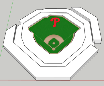

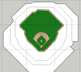

To create the template for each layer I used SketchUp.
I imported an image of Citizens Bank Park I found online, adjusted its size to be 24" x 24" and then used the line tool to manually trace the outline.
I then used the line tool and followed seat sections and referenced an actual photo of the stadium to play with the different layers and elevations using the push pull tool.
Finally, I added guide lines to the model to make it easier to align the printed pages of the template.
*You can no longer print full scale drawings with SketchUp unless you upgrade or have an education account as a student or teacher.
I am sure there is a better digital tool to do this with. An Adobe product? Fusion? If you have an idea, I'd love to hear about it!

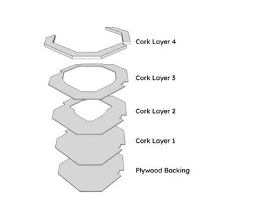

Step 2: Plywood Backing
The plywood will be the first layer, and provides a durable substrate for the cork. This will also become the master template for the outside of all the other layers.

Step 3: Cork - Rough Outline
In this step you are going to cut out the rough outline of the first three layers of cork, using the plywood backing as a template. Later you'll use the router and flush trim bit to bring these to final dimension.

Step 4: Cork Layers 2 and 3
Next you'll use the paper template to transfer the inside cut for the 2nd and 3rd cork layers.
Cut out the inner cut line from the paper template and transfer to the 2nd cork layer. Cut this line as precisely as you can. Repeat this process for the 3rd layer.

Step 5: Cork Layer 4
Upper Seating
Next you'll glue together your cork off-cuts to build extra thickness and cut out the two final components. The outside edge of these components will be cut over-sized and flushed up with the router later.

Step 6: Assembling 1st Cork Layer
In this step the first layer of cork is glued to the plywood backing and flushed up with the router.

Step 9: Final Assembly
Layers 2 and 3 will be glued in place, and trimmed flush before a chamfer is added to their outside edge. The 4th layer pieces will then be glued, painted and trimmed flush, and finished with a chamfer all the way around.
