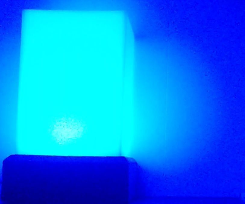

Step 3: Light
Cut your led strip to the right size (aprox. 110mm).
Drill a hole from the storage area to light groove and a hole from the storage all the way trough.
lace the wires trough the holes before soldering and tie a knot to prevent the light from breaking when accidental pull on the wires.
connect your power supply to the led strip with solder, and put the leds in place.
next glue the perspex in place. flush with the surface.
