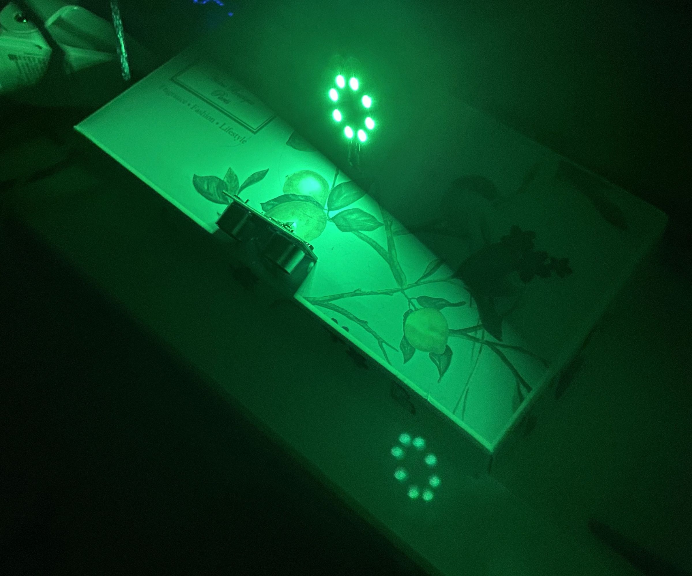

Step 5: (Optional) Make a Box for Your Device!
*This step is optional, not doing it won't affect anything.
I used a normal paper box, so I could hide all the cables inside. If you are willing to do this step, make sure you cut the holes for the power cable, for the Photoresistor, and for the LED.
