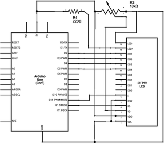

Place the LCD screen and the buttons in the slots and place the Arduino underneath. On the other side, hot glue the motor and battery pack so that one blade of the motor is through the slit.
Step 4: Assembly Part 2
Connect the electrical components following the picture above.
