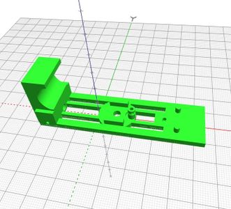

1: CamclawA 87(L) x 24(W) x 29(L) mm, Weight: 12g
2: CamclawB 75(L) x 24(W) x 27(L) mm, Weight: 9g

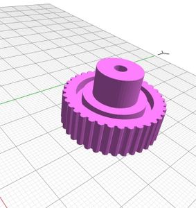

3: Clampknob 32(dia) X 19(H) mm, Weight: 10g

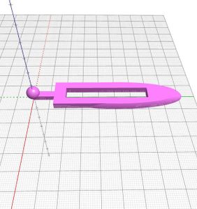

7: Trileg40 20(W) x 96(L) x 8(H) mm, Weight: 5g

Some pre assembly of the clamp knob is required.
Sit a M4 x 8mm threaded insert into the large opening in the clamp knob.
Using a soldering iron apply the tip to the top of the threaded insert and applying light pressure push the insert down into the body of the knob until the insert is flush with the top of the knob.
A cocktail stick (or other slim non conductive rod), can be used to adjust the insert if its off vertical, as its an insulator it will not cool the insert during adjustment.

Orientate ClawA with the raisied end on the right and facing uppermost.
With a 4mm drill bit widen the hole in the centre of the claw.
Orientate ClawB with the raised end on the left and facing uppermost.
Align ClawB over ClawA such that the long rectangular cutouts in ClawB align with the raised rectangular and cylindrical locators on ClawA.
Once attached it should be possible to slide the two claw elements to narrow or widen the gap between the claws.
If the claws cannot be opened to the full extent it may be due to narrowing of the rectangular cutout, this can be remedied by filing the inner edges of the rectangular cutout close to the short side.
Additionally a little silicone grease can be applied to the surface to increase the slip.
Next align the retainerM2 to the right of the claw assembly and fix in place with a M2 x 6mm screw but do not over tighten as the claw assembly needs to slip freely.
Taking the retainerM4 fit a M4 x 35mm Allen socket head screw, driving in the screw until the head sits in the cylindrical recess. Do not widen the hole to ease insertion of the screw as it needs to fit tightly in the retainer.
It may be necessary to hold the retainer in a vice during this process to ensure the screw is correctly aligned.
Worst case if the screw spins than apply a little strong adhesive to the retainerM4 and the screw head.
Pass the threaded part of the M4 x 35mm screw from the front and into the centre hole of the claw assembly.

Drive the clamp knob (threaded insert facing away from M4 screw), onto the M4 screw.
Prevent the screw from spinning with an Allen key in the screw head whilst the knob is fully fitted in place.

Orientate a trileg with the ball end into the spherical cavity and the rectangular beam aligned with the rectangular slot.
Repeat this process for the other 2 legs.
