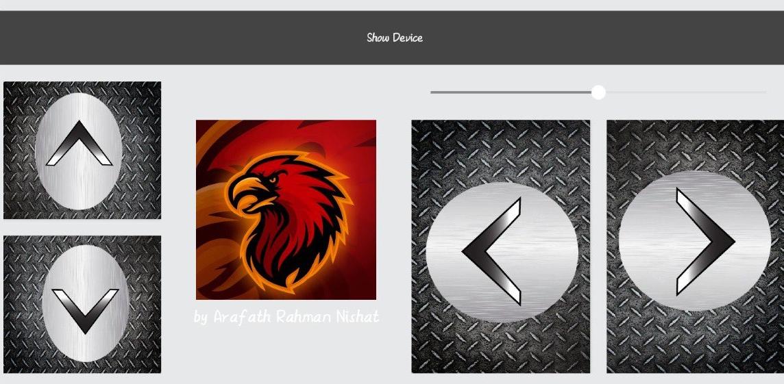

Step 4: Application Design for Controlling the Car
I made an app (Phonix_V1) with the help of MIT app inventor to control the car with an android device. Block code for MIT app inventor is attached here.
