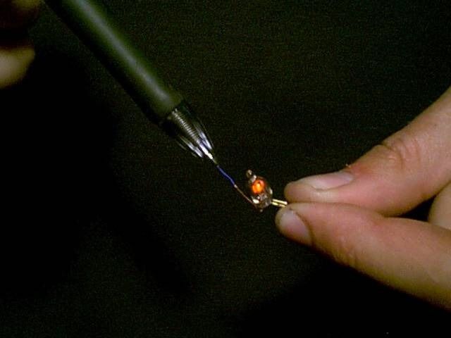

Another trick is fitting a blue LED into the tip of the body of what used to be a ballpoint pen. As an added complication I want the LED to turn on only when it is pressed against the pad. That way it "marks" in the same manner as a pen or pencil, which marks only when pressed against the paper. If the LED is always on, I get an effect that is more like spray-paint, and that isn't the effect I want.

Step 12: Putting It All Together
It really does go together just like shown in the diagrams presented in Step 8.
The first picture here shows a virgin blue LED, side by side with one which has had its leads trimmed and shaped so that it can be pressed into the plastic shaft that used to be an ink cartridge.
The second pic shows what the shaft actually looks like: LED on one end, and a brass screw switch contact on the other end. The fine gauge (30 AWG) blue wires go to the LED. The switch contact, on the shaft, has an orange wire soldered to it.
The third picture shows some detail of what the other switch contact looks like.
The forth picture shows the AA battery holder, which has undergone a serious makeover too. Its been converted from a 2-cell AA holder, into just a 1-cell holder, and the empty space is being used to hold the LED-driver module and other components. Also visible in the forth picture are wiring connections to the light-emitting pen. These connections, insulated by masking tape, will be covered up by the pen's cap when in use.
The forth and fifth pictures show me testing the switch. Just a very small force against the LED/stylus is necessary to make it light up.
As described in Step 8, the force I am actually pushing against comes from a small section of the spring, which is always trying to pull the shaft forward, and open the switch.
