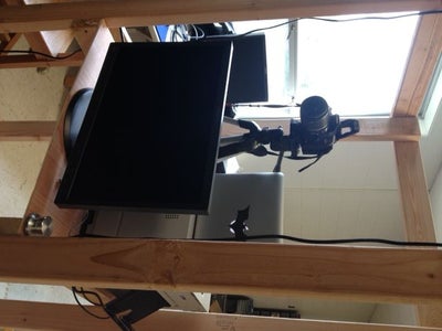

We purchased the wood at Lowes, so to save time we had them cut the pieces to the lengths that we needed right in the store. As you can see in the pictures, we created the photo booth in two parts that could easily go through a door and were manageable for one person to roll and two people to lift.
To make the frames for the photo booth, create 6 boxes by nailing the 2' boards to the interior of the 3' boards. Then nail the 6' boards to the exterior of the boxes you created (on the short sides). For the bench side of the booth one box should be at the top, one box at the bottom, and one box should have its top 17" off the floor. For the electronics side of the booth one box should be at the top, one box should be at the bottom, and one box should have its top 3' off the floor.
Affix four locking casters to the bottom of each unit if desired. These make the photo booth much easier to move into position for events!

How expensive the electronics that you use are really depends on the quality picture that you want to get. We wanted a high quality print that was fully automated so that we didn't have to have someone with knowledge of the inner workings running the thing, and we could charge a decent fee while the customers still feel like they got a good product for the price. There are many photo booth softwares on the market, however after researching A LOT of them I decided to use dslrBooth because it was easy to use, didn't break the bank, had all of the features I was looking for, and was compatible with a dslr camera. Many other softwares use webcams, so if that is more your price range then look for a different software! We also splurged on the DNP DSRX1 dye sub color printer because we were looking for a high quality, quick print that would also cut the 4 x 6 sheets into 2 - 2 x 6 photo strips. The final main components were a USB button to get the whole thing started and a couple clamp lights! We went with the Griffin Powermate and two cheap clamp lights from Lowes.
I already had the camera, monitor, laptop, tripod, usb man, power strip, and all of the accompanying cords. I hooked the powermate and the printer into the usb man, and plugged the usb man into one of the usb ports on my laptop. The camera gets plugged directly into the other usb port on my laptop. The external monitor was plugged into the mini display port on my laptop and I mirrored my screen so that what they see in the photo booth is exactly what is set up on my screen. The lights, printer, laptop, and monitor power cords are plugged into the power strip, which is plugged into the wall.
