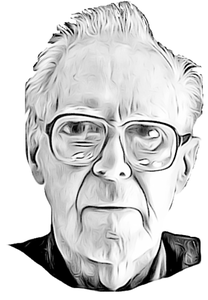

Step 3: Additonal Prep Using BeFunky
I use BeFunky Digital Art Oil Painting DLX filter to increase contrast and detail. Take screenshot unless you have purchased the software.

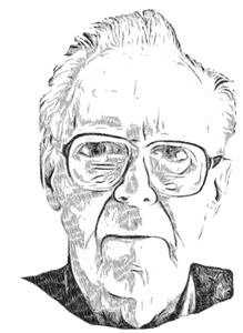

Step 4: Convert to Line Drawing Using Sketchmee
Sketchmee Pro (purchased on MacOS, can also use the iOS iphone app but has less features) - I like using 3 layers with high detail. Save as PDF - transparent. More detail or layers than this will create too many objects for the laser cutter buffer.

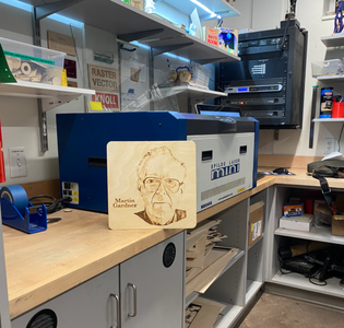

Step 6: Print on Laser
I then save as PDF and import to Corel for laser printing. Convert all lines to “hairline”. Color map settings are below for my laser cutter (Epilog mini 40w). I group objects by color in separate layers and print each layer separately (lower power layers to higher). I recommend this layering step in order to reduce the number of objects sent to the cutter as I have had print jobs error due to memory overload. The total print time for this portrait takes about 70 minutes on this machine.
Step 7: Sanding to Complete.
A little bit of sanding to remove burn markings.
