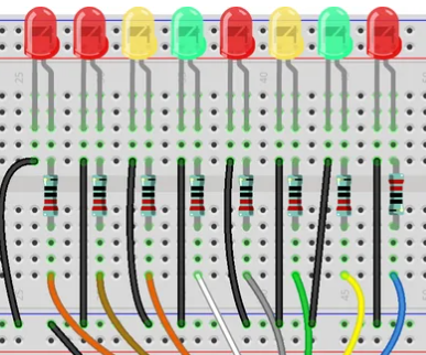

Step 2: Build Your Circuits
Here, I will show you how my circuits are connected, there will be small steps to follow
Step 3: Circuit - 1
You just have to do the same thing to get this thing to work. But if you want to add in LED, you just have to do the same way but just connect your wires to a new pin.
Step 4: Circuit - 2
This is the product you will make out
