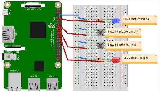

i also added 2 button before the way the software work on the touchscreen can be sometime confusing but it's optional you can use either
The button pin are set as it in the code so it will work once connected

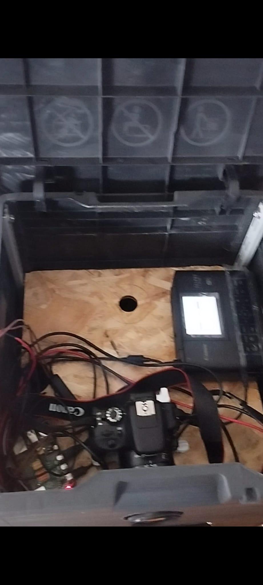

Step 2: BOX Mounting
I did some basic craft , i bought a planch of wood cut it and put the camera at the right height .
I then put everything inside camera printer touchscreen and did the hole for everything !

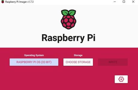

how to Install OS on the SD card:

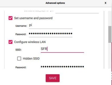

i would recommend to use raspberry pi imager as it is easy to use and you can automatically setup wifi
-Select the OS (Raspbian) then select the storage (SD Card)
-Click on the gear icon , you just need to tick the box and your wifi will be pre configure
Once done either connect on you administration box to know the IP or use Ip scanner
Now that you have the IP connect whith Putty with the username and password

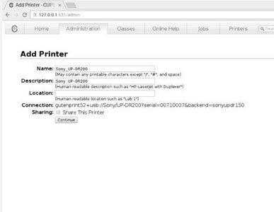

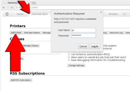

Open the Internet browser by clicking on the blue globe icon at the top left of the taskbar. In the URL bar, enter the following address:
http://127.0.0.1:631
Then press ↵ Enter. This will open the CUPS configuration page in your browser.

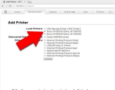

Click the Administration tab. Then click Add Printer. You will be prompted to enter your username and password.
The default username is piand the default password is raspberry unless it has been previously changed.

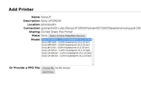

Select your printer from the list of local printers and click Continue. Ignore the VNC remote printer and don't worry if your printer is listed twice.

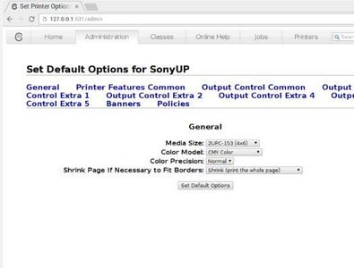

Rename your printer to something easy to remember and simple to type. In the example shown, we'll rename the default printer Sony_UP-DR200 to just SonyUP to make it easier to remember and type. You can also enter a location tag if you wish. In this example, we'll enter photobooth as the location. Then click Continue.
Select the printer driver for your printer brand and model. Then click Add Printer.
Select the default setting print meters you prefer on this printer. If you don't know what a particular setting does, it's best to leave it alone. The most important setting is to make sure the media size matches the paper size you are currently using. Then click on Set default options. You should see a confirmation page that says "The default options for printer 'YourPrinterName' have been set successfully." This will then redirect you to the main printer status and task page.

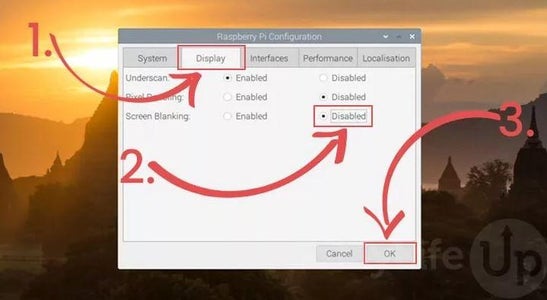

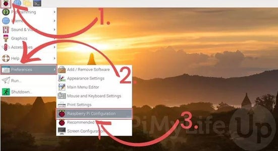

Remove screen sleep (See photo);
You can get to this menu by clicking the raspberry icon in the top-left corner .
With the start menu opened, you need to hover over the “preferences” option near the bottom of the menu .
Finally, click the “Raspberry Pi Configuration” option
With the Raspberry Pi Configuration menu opened, you will need to first change to the “Display” tab
Within this tab, you should see the option named “Screen Blanking“, click the “Disabled” button next to the option
Once the option is disabled, click the “Ok” button to apply the change
If you use DLSR camera you should do the same and also for the printer.
