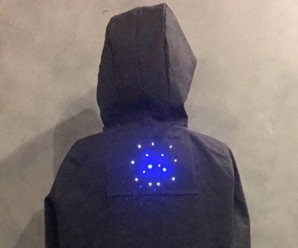

Introduction: Photocell Sensor Garment
Photocell sensor garment connected to sewable LEDs // Coded with Arduino UNO
Step 1: Create the Garment
For my garment I used:
- Organza, wool roving (felted on tulle), and polyester lining with a ribbon to tie the back
Step 2: Code the Photocell With Arduino + Test It Out

Step 3: Sew the LEDs on With the Circuit + the Photocell
Step 4: Light It Up!
