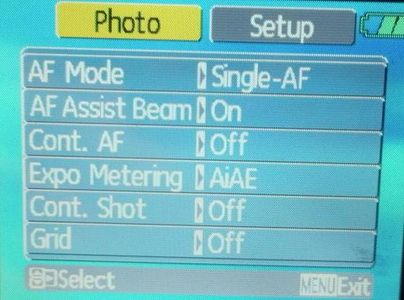

How to get a 30 second exposure from the GE A830:
-Turn the top dial to manual mode (see first photo below)
-Press menu (2nd photo)
-go up one step to "slow shutter" and set the shutter to 30 seconds. (3rd, 4th and 5th photos)
-Press OK
On a clear night take the camera to an outdoor location away from bright lights. For simplicity, place the camera on the pavement pointing up. Press the shutter button and wait 30 seconds for the photo to finish. Do not touch the camera (you may want to delay the taking of the picture for 2 or 10 seconds to make sure no vibration will affect the camera.
