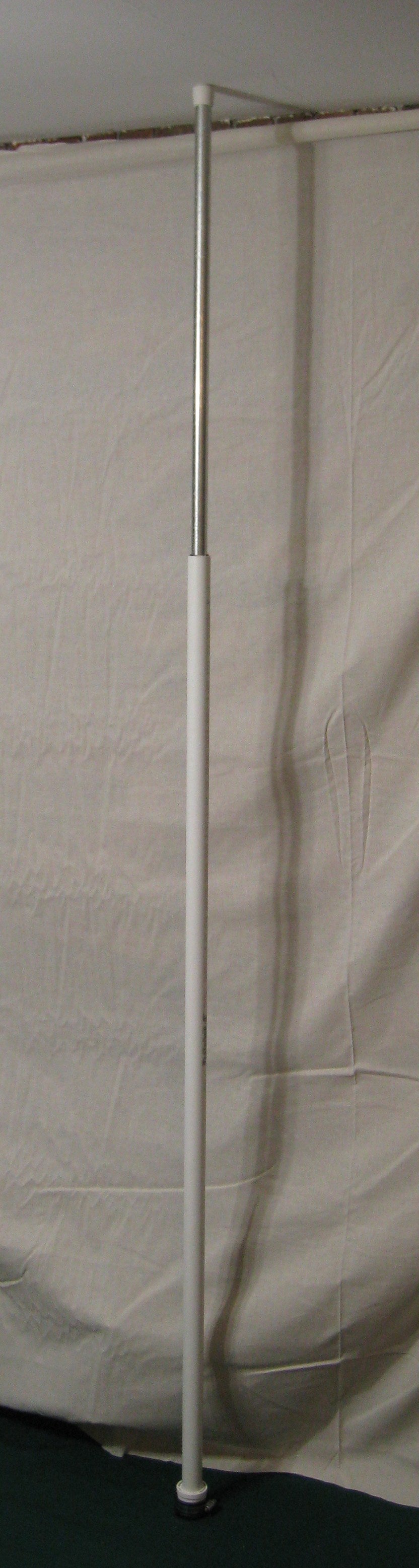

Your pole is now complete. Spin the conduit counter clockwise to the PVC, and it will extend, slowly, keep it compressed once you are near the ceiling, and keep extending until you are about an inch or two from the ceiling, and release, et voilà, a stationary pole.
If you want to make it more professional looking, you could paint the pole black, and use black chair tips.
One thing I notices is that the threaded rod tends to bang around inside. You could turn down one of the nuts, glue to the very end, and add fleece, but you would have to cut the conduit a bit shorter to do that.
