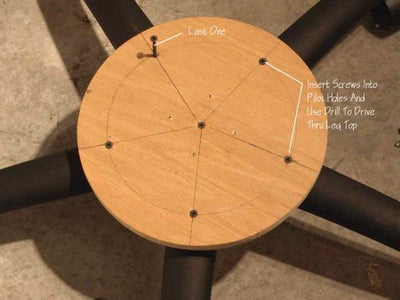

Step 2: Center and Mark You Base.
Mark for pilot holes about 1" off edge. Drill the holes a little larger than the diameter of the deck screws. The head of the screw should not slip through the plywood.
Step 3: Center the Base and Drive the Screws.
If you have a power screwdriver this step will be much easier. Center the wood base over the leg set. Use the power of the driver to self tap the screws into the plastic of the leg set. If you have to do this by hand power then us a nail to make a small pilot hole first. You want the screw threads to cut into the plastic.

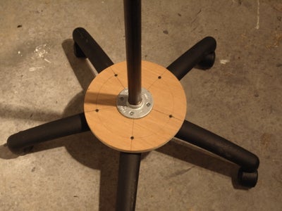

Step 4: Attach the Flange.
Center the floor flange by eye and mark for pilot holes. Drill the holes using a small drill bit.
Step 5: Attach the Flange.
Using the four wood screws.
Step 6: Mount the Standard.
Insert the pipe standard and tighten hand tight only. If the pipe leans to one side or the other (mine did because the flange was drilled out of square) you can correct that. If you tighten a screw away from the direction of lean and loosen one in the other direction you can get it perfectly plumb.

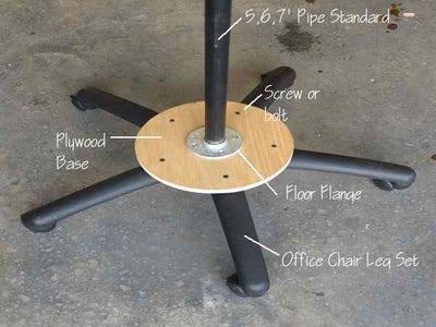

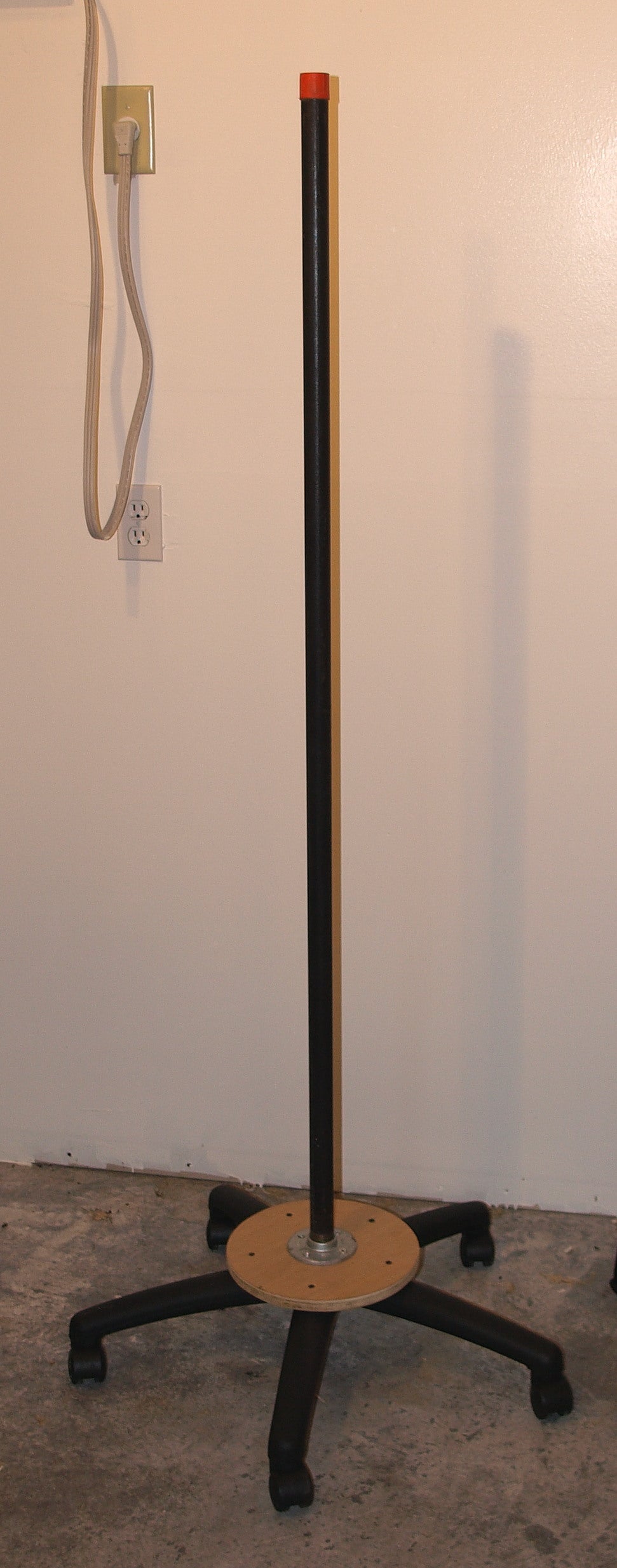

Step 7: A View of the Finished Stand.
Here's what it looks like all put together with the parts labeled.
