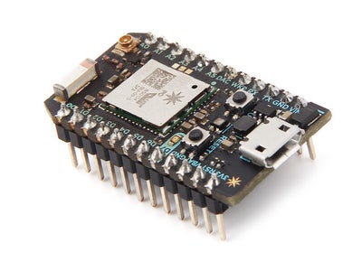

- Photon Board

Set up is very simple! The base servo (Servo 1) should be attached to pin D0. The second servo should be attached to pin D1, the third servo to pin D2, and servo 4 to pin D3.
Step 4: Code and a Brief Explanation of How It Works
The HTML, JavaScript, and Arduino code can be found right here. Simply flash the .ino code onto your Particle Photon board, edit the JS file "calculations.js", and use the provided HTML file to get started.
You will need to edit the file and put your device ID and access token where specified in the JS file.
