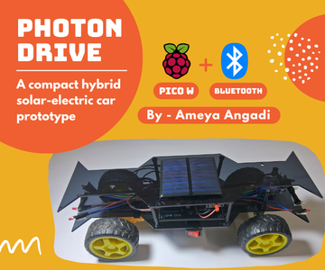

Introduction: Photon Drive — Intelligent IoT-Based Solar Car
About: I’m Ameya Angadi, a robotics and electronics enthusiast creating easy-to-understand open-source tech. From Arduino to Raspberry Pi, IoT, and automation, I aim to spark ideas and solve problems. Whether you're …
Photon Drive is a compact, IoT-enabled, solar-powered hybrid vehicle designed for clean, efficient, and interactive mobility. Using Raspberry Pi Pico W, the project combines solar and battery charging, Bluetooth-based control, sleek aesthetics, and smart lighting — all inside a custom-designed laser-cut acrylic chassis.
Whether you're a hobbyist, student, or sustainability enthusiast, this project is a great hands-on way to explore embedded systems, electronics, 3D design, and open-source prototyping.

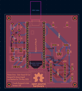

Step 1: Design the PCB (JLCPCB)
Design your custom PCB to simplify wiring between motor driver, Pico W, lights, and power.
📌 I used KiCAD for schematic and board layout, then ordered from JLCPCB - a reliable and affordable PCB manufacturer.
🔗 Link to avail special coupon worth up to $70- https://jlcpcb.com/?from=Ameya
Download gerber files by clicking here

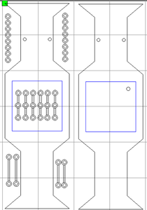

Step 3: Laser Cut the Chassis
The car body was made from laser-cut acrylic sheets. The design was done in RDWorks software and cut using a laser cutting machine.
I went with a black semi-transparent acrylic sheet for the chassis, as I felt it would match the overall look of the car.
I have created extra copies for each part just so that they can be used to solve any mistakes/breakage.

Step 6: Assembling the PCB
To assemble the control PCB for the Photon Drive solar IoT car, begin by soldering all the THT (Through-Hole Technology) components onto the board.
  1. Use JST connectors for the headlight, backlight, left and right indicators, as well as for the battery connection. This allows easy plug-and-play functionality and quick replacement when needed.
  2. Solder four 220Ω resistors in series with each LED connection. If you find the brightness too low, you can replace these resistors with wires, but be careful not to overload the LEDs.
  3. I've used male headers for both the Raspberry Pi Pico W and the TB6612FNG motor driver, and the Servo making them removable and reusable for other future projects.
This is my first attempt at designing a PCB! While everything works correctly and looks quite professional, I welcome any feedback or improvements you might suggest in case there are technical mistakes I might've overlooked.
