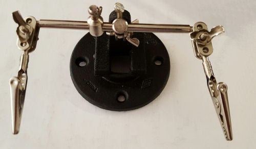

My "store bought" "helping hands" came with a magnifying glass attachment. I personally found this more of a hindrance than a help, and quickly discarded it. However, being raised frugally, I have learned never to throw away anything that may be useful in the future. Usually when using the "helping hands", holding the work stationary was nice, but seeing, what I was holding, was nicer still.
The "helping hands" fixture uses brackets, connected with bolts and wing nuts, to hold its attachments.

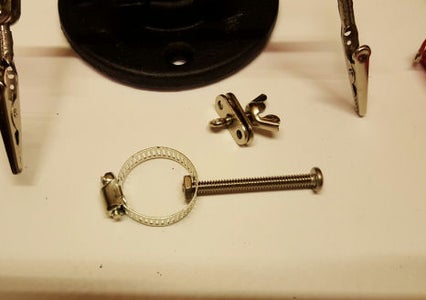

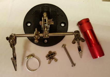

For my "Photon Generator" (flash light), I simply used what was already there, and a couple of simple parts:
A round head screw, a nut, and a hose clamp. Modifications required were to drill a hole in the hose clamp to accept the screw.

Drill a hole in the hose clamp that will allow the screw to pass through.

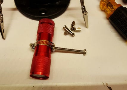

Clamp the screw and nut assembly around a flashlight,.

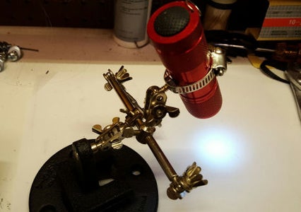

The head of the screw will fit into the clamping assembly of the "helping hands", where the magnifying glass used to be..
(I used a shorter screw in my assembly to position the flashlight).

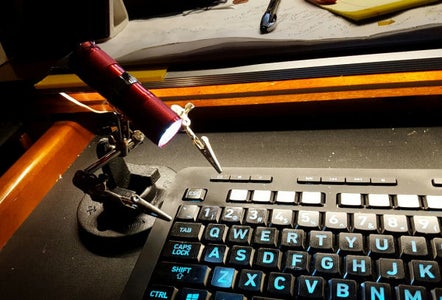

Step 3: Using the Photon Generator
No problem here.
Turn on the "generator" and point it it at what you want to see..
