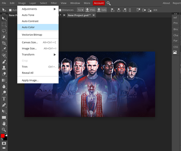

Step 4: Step 4: Auto-Contrast and Auto Color
While we still are on the layer, go to the Image tab at the top left . Select Auto Contrast and auto color to make the color more prominent.
