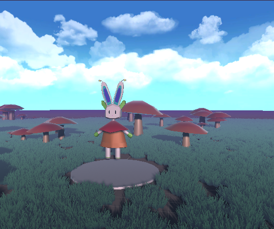

Step 4: Unity
For Unity:
Open a new project and add a visible light to the scene.
Then add a new script, I called it LightControl and paste in the following code:
using UnityEngine;
using System;
using System.IO.Ports; //if this line of code causes trouble, then go to Edit > Project Settings > Player > Api compatibility level and change the input to .NET Framework
public class LightControl : MonoBehaviour //change filename if you put another name there
    // Variables for serial communication
    private string portName = "COM3"; // Adjust port name as needed
    private int baudRate = 9600;
    private SerialPort serialPort;
    public float intensityMultiplier = 100f; // Adjust this multiplier as needed
    void Start()
        // Initialize serial port
        serialPort = new SerialPort(portName, baudRate);
        try
            serialPort.Open();
        catch (Exception e)
            Debug.LogError("Error opening serial port: " + e.Message);
    void Update()
        if (serialPort != null && serialPort.IsOpen)
            try
                // Read data from Arduino
                string data = serialPort.ReadLine();
                int lightIntensity = int.Parse(data);
                // Print input of photoresistor to console
                Debug.Log("Light intensity: " + lightIntensity);
                // Map light intensity to a range suitable for the light component
                float normalizedIntensity = Mathf.Clamp01(lightIntensity / 1023f);
                // Apply intensity to the light
                Light lightComponent = GetComponent<Light>();
                lightComponent.intensity = normalizedIntensity * intensityMultiplier;
            catch (Exception e)
                Debug.LogError("Error reading from serial port: " + e.Message);
    void OnDestroy()
        // Close serial port when the script is destroyed
            serialPort.Close();
Put this script on your light object in the scene and press play.
Check in the console if it's putting out numbers.
Then select your light object and check the intensity, if it's really low, go to your script and change the Intensity Multiplier. Mine is set to 10.
Your light should now change based on the input from your Photoresistor.
If nothing happens, check if the serial monitor in Arduino IDE is still running, if so, close it, and restart the Scene in Unity.
