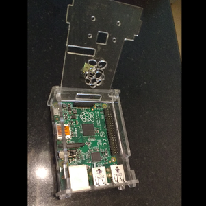

Raspberry pi with latest Raspbian

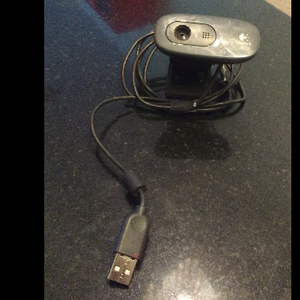

webcamera
PIR (motion) sensor

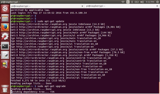

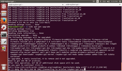

Update the pi with two steps
1) update the list of available packages and their versions
2)install newer versions of the packages you have
this may take long time depending on your Internet speed
sudo apt-get update
sudo apt-get upgrade

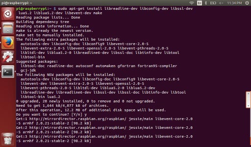

Install libs: readline or libedit, openssl and (if you want to use config) libconfig and liblua. If you do not want to use them pass options --disable-libconfig and --disable-liblua respectively.
sudo apt-get install libreadline-dev libconfig-dev libssl-dev lua5.2 liblua5.2-dev libevent-dev make
sudo apt-get install libjansson*

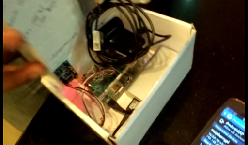

Here it goes when pir is triggered, camera should take image and send to telegram.
PIR (motion) Sensor
motion gives high pulse when it is triggered, so we active the camera when we get raising edge (0 to 1).
Camera
image is taken and stored in a folder /home/pi/ with name image.img
send image to telegram
now send the /home/pi/image.img to telegram
