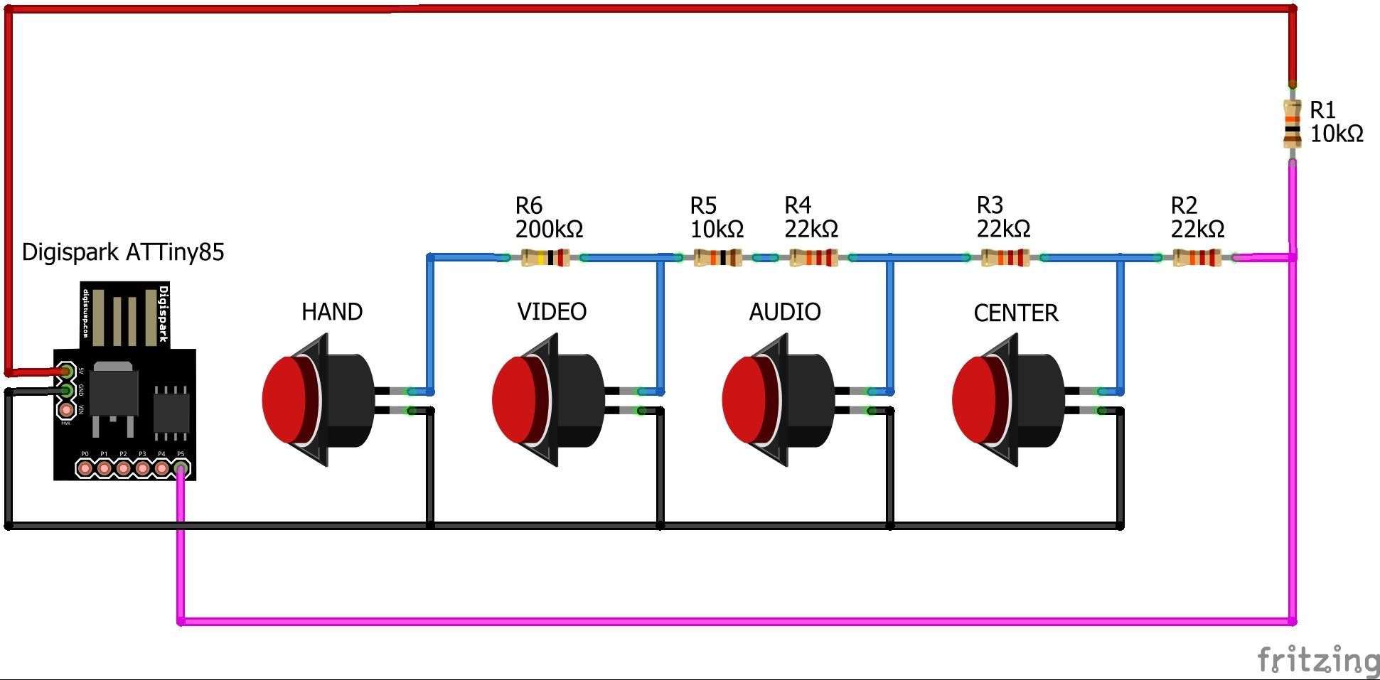

In this project, I used DigiSpark ATTiny85's reset pin (PB5 or ADC0) as the multiple analog buttons without setting Fuse Bits. The schematic is as follows:
ATTiny85 & pushbuttons in this project works like an USB HID (Human Interface Device) keyboard. There are 4 pushbuttons and their functions describes below:
Center Button: Enter (short press less than 1 second) or Exit (press and hold more than 2 seconds) the Zoom meeting window.
Audio Button: Mute/ Unmute my Audio.
Video Button: Start/ Stop Video.
Hand Button: Raise/ Lower Hand.
The table below shows the voltages and analog values at ATTiny85's PB5 pin corresponding to each push button when it is pressed:
With this hardware config, PB3 (USB+), PB4(USB-) and RESET (PB5) pins are used and I have 3 pins left for further development:
PB0 (SDA) and PB2(SCL): can be used for I2C related further development applications.
PB1(PWM1): can be used for PWM control.
⦾ Or PB0 (MISO), PB1 (MOSI), PB2 (SCLK): can be used for SPI communication.

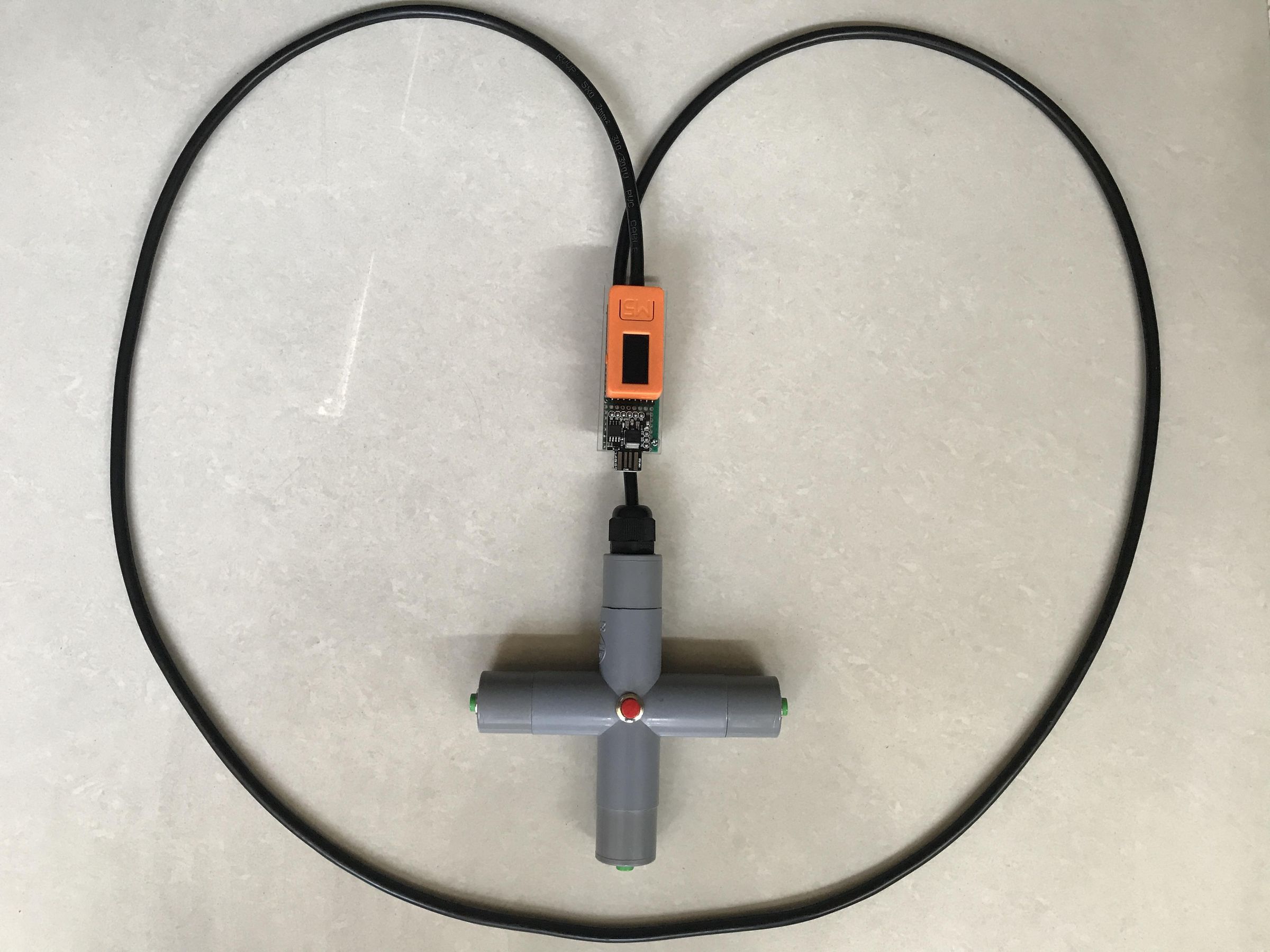

Step 3: Assembly

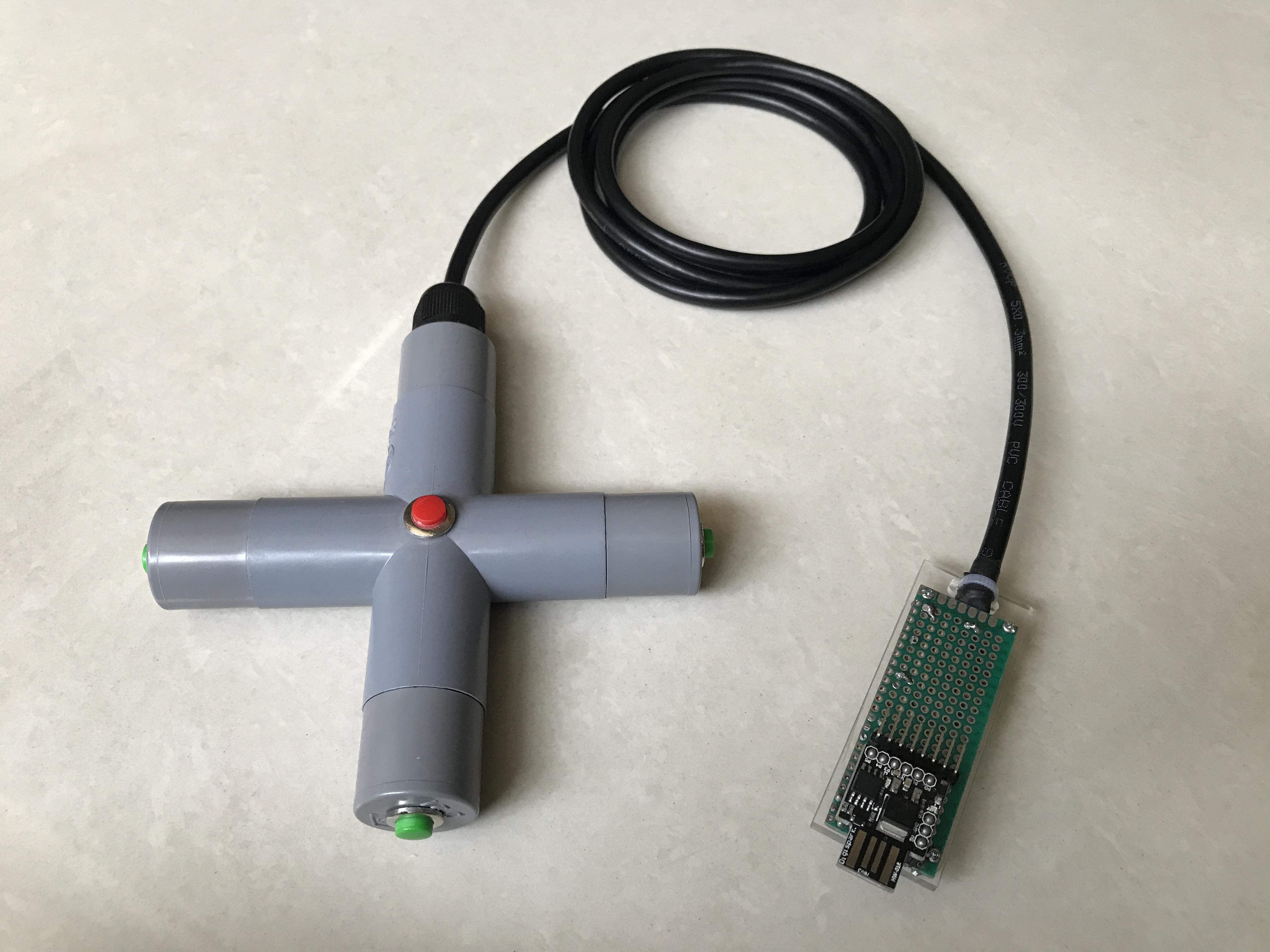

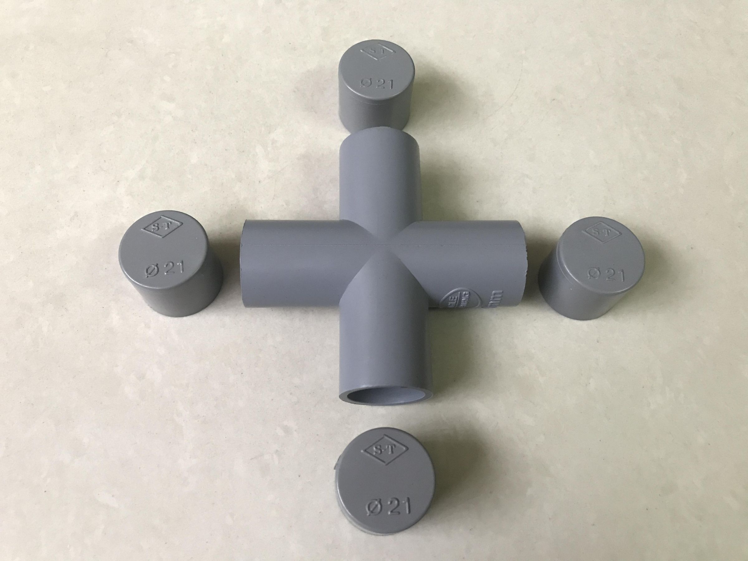

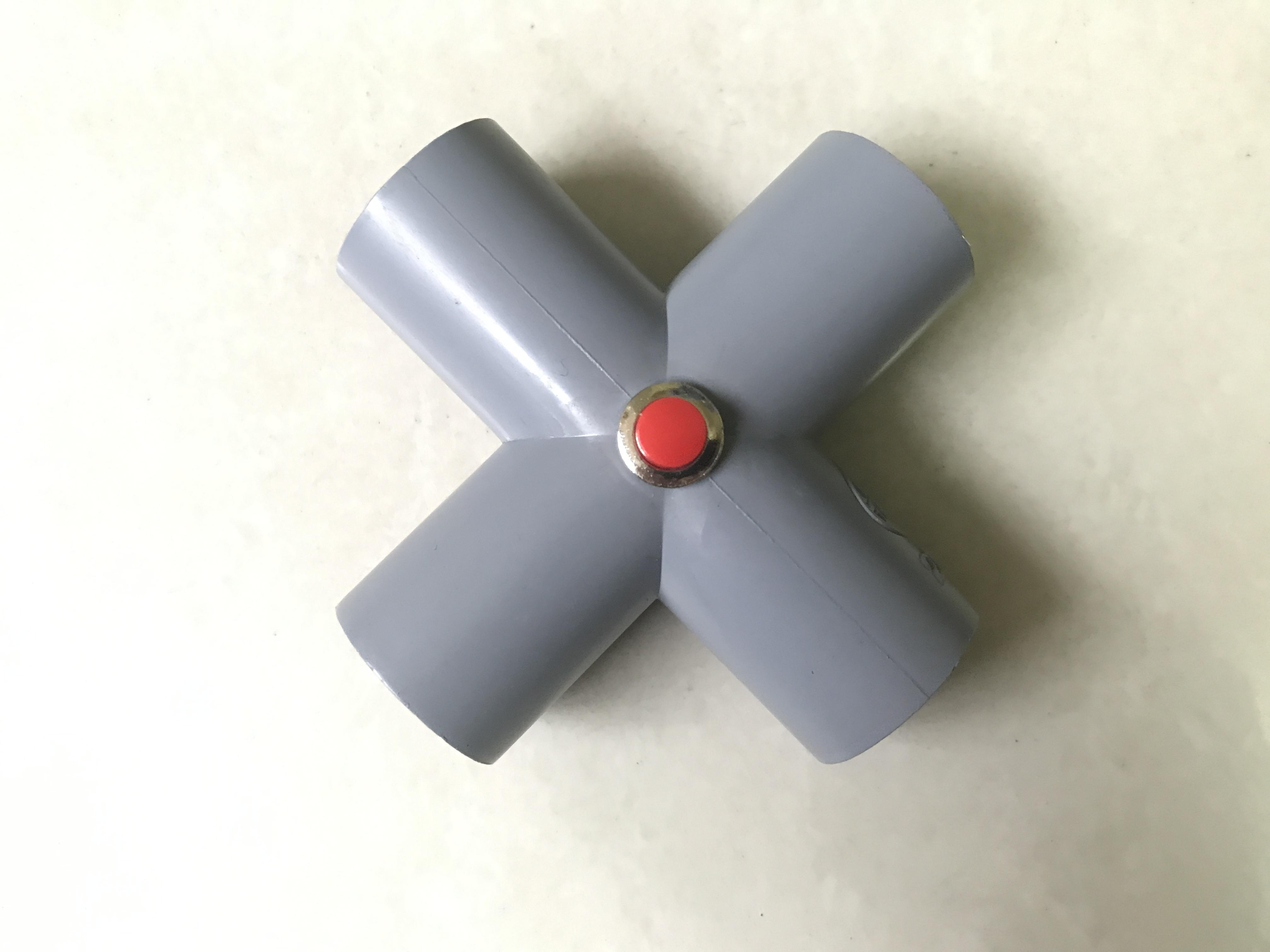

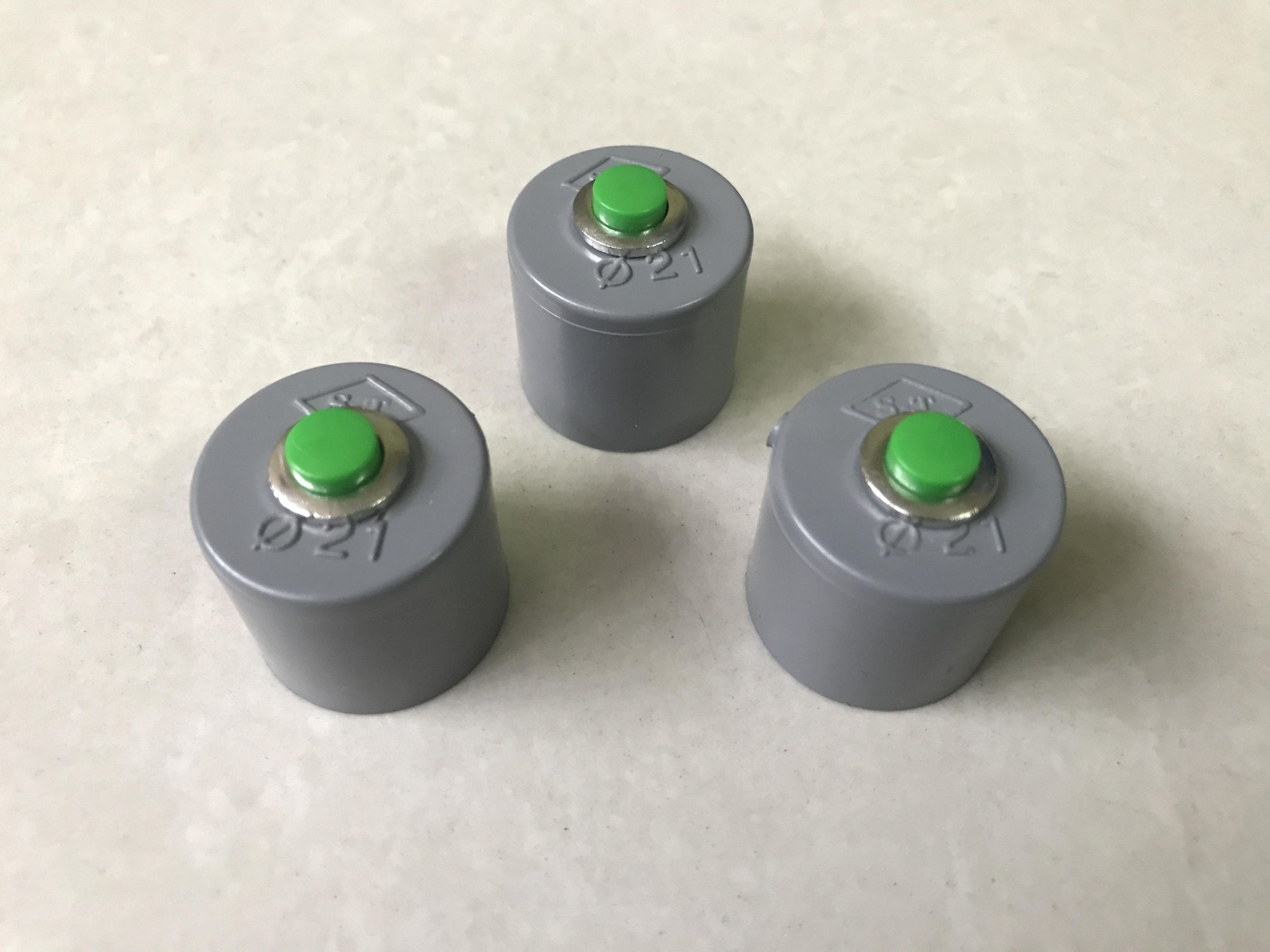

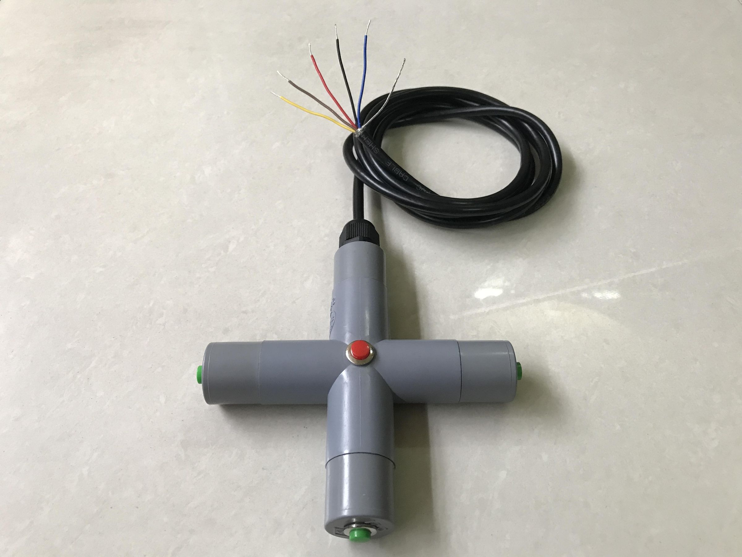

Prepare PVC pipe fittings Ø21mm: one cross and four end caps.
Drill holes on 3 end caps and install 3 green push buttons.
Drill hole on the PVC cross center and install red push button.

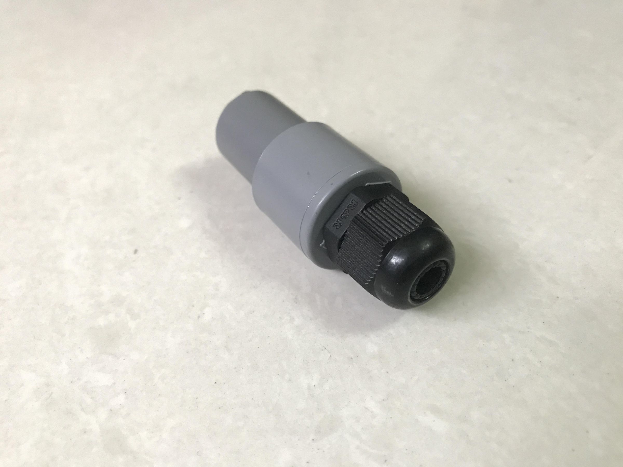

Mount cable gland on the remaining end cap.
Solder 5 cores cable to 4 push buttons, joint 4 PVC end caps and cross together.

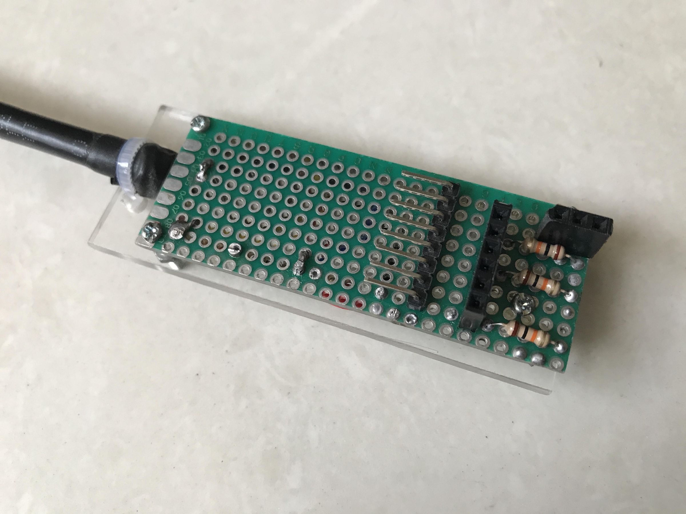

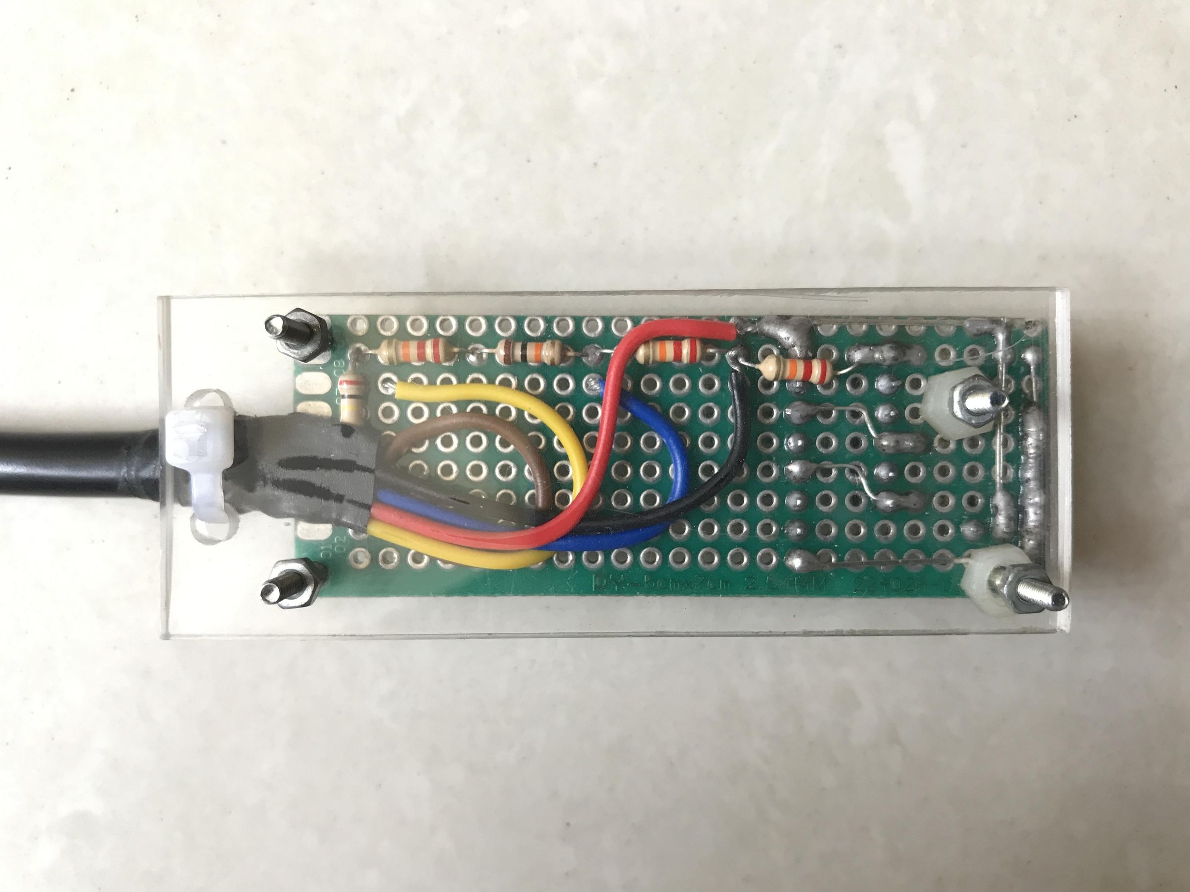

Cut the PCB 5x7cm in half, solder the resistors, 5 core cable at the bottom and mount this PCB on a small acrylic sheet, fix the 5 cores cable by cable tie.
Female headers for ATTiny85 were soldered on the PCB top. The I2C pull-up resistors 10K and 8-pin male header for M5StickC were also soldered for further development.
Plug DigiSpark ATTiny85 on the PCB control board. DONE!!!

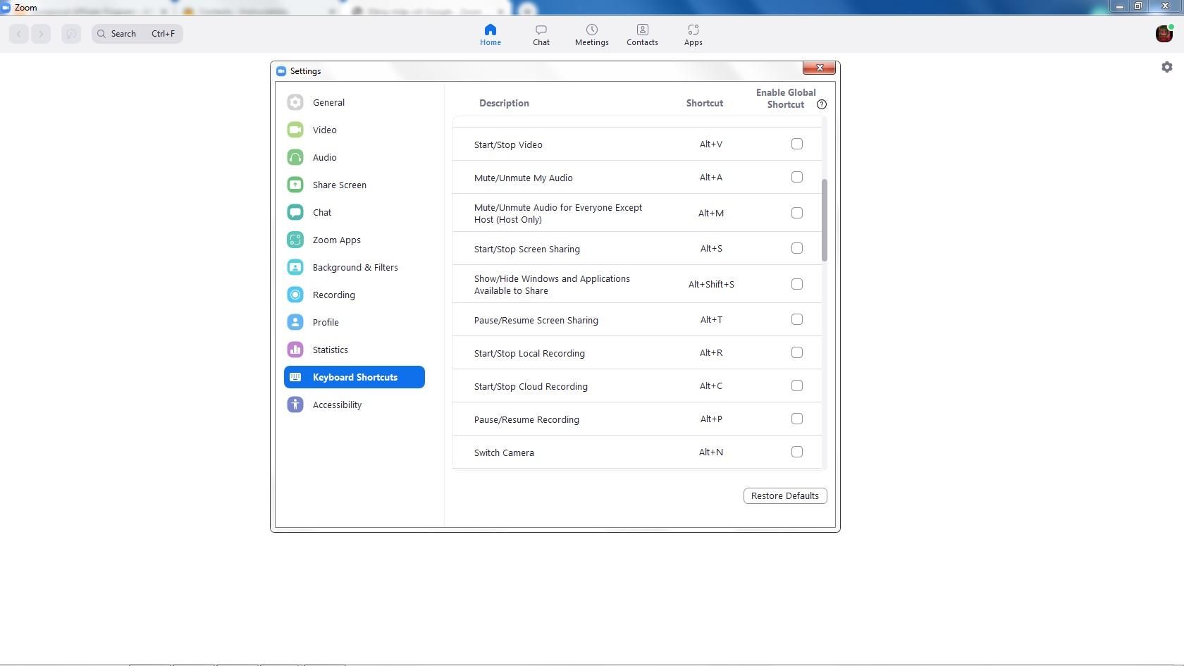

Download and install Zoom Client for Meetings software in my computer.
Open Zoom ‣ Settings ‣ Keyboard Shortcuts
Record the shortcuts that I want to use for my buttons, in my case, they are:
⦾ Mute/ Unmute My Audio: Alt + A.
⦾ Start/ Stop Video: Alt + V.
⦾ Raise/ Lower Hand: Alt + Y.
⦾ Close Current Window: Alt + F4.

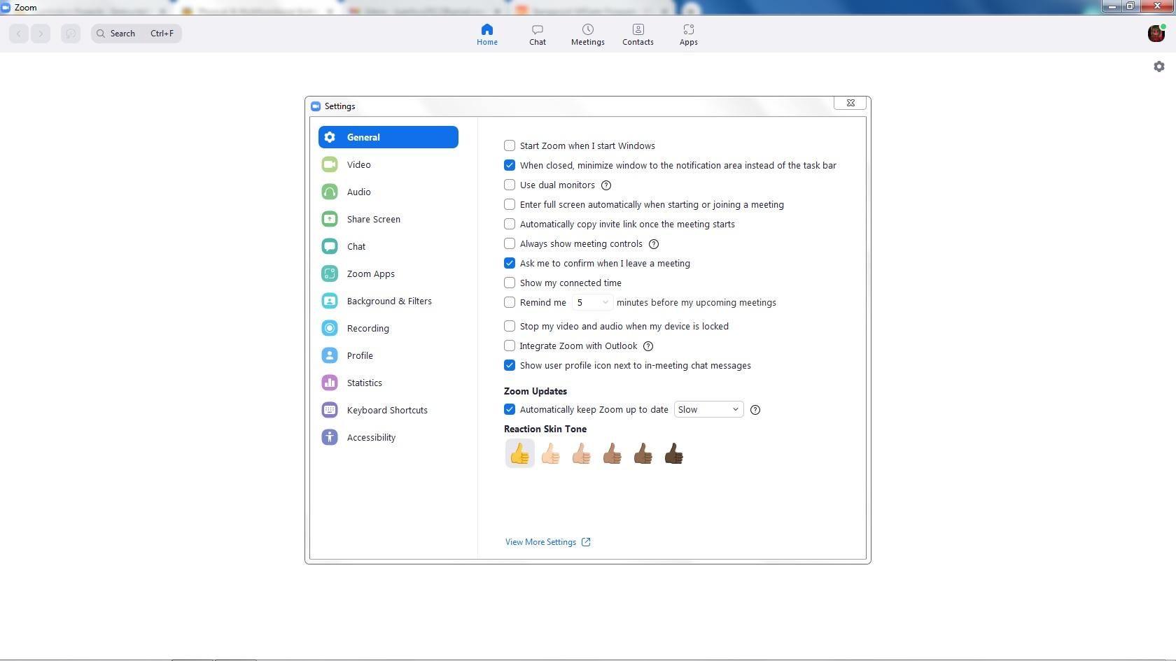

For the kids we can set up the following options:
Open Zoom ‣ Settings ‣ General
⦾ Start Zoom when I start Windows.
⦾ Enter full screen automatically when starting or joining a meeting.

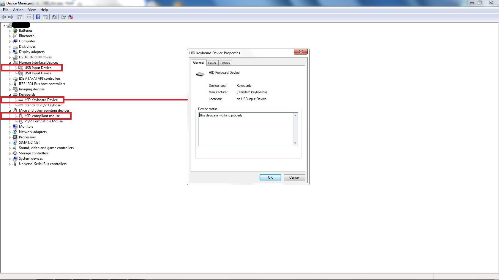

Step 7: Testing & Notes

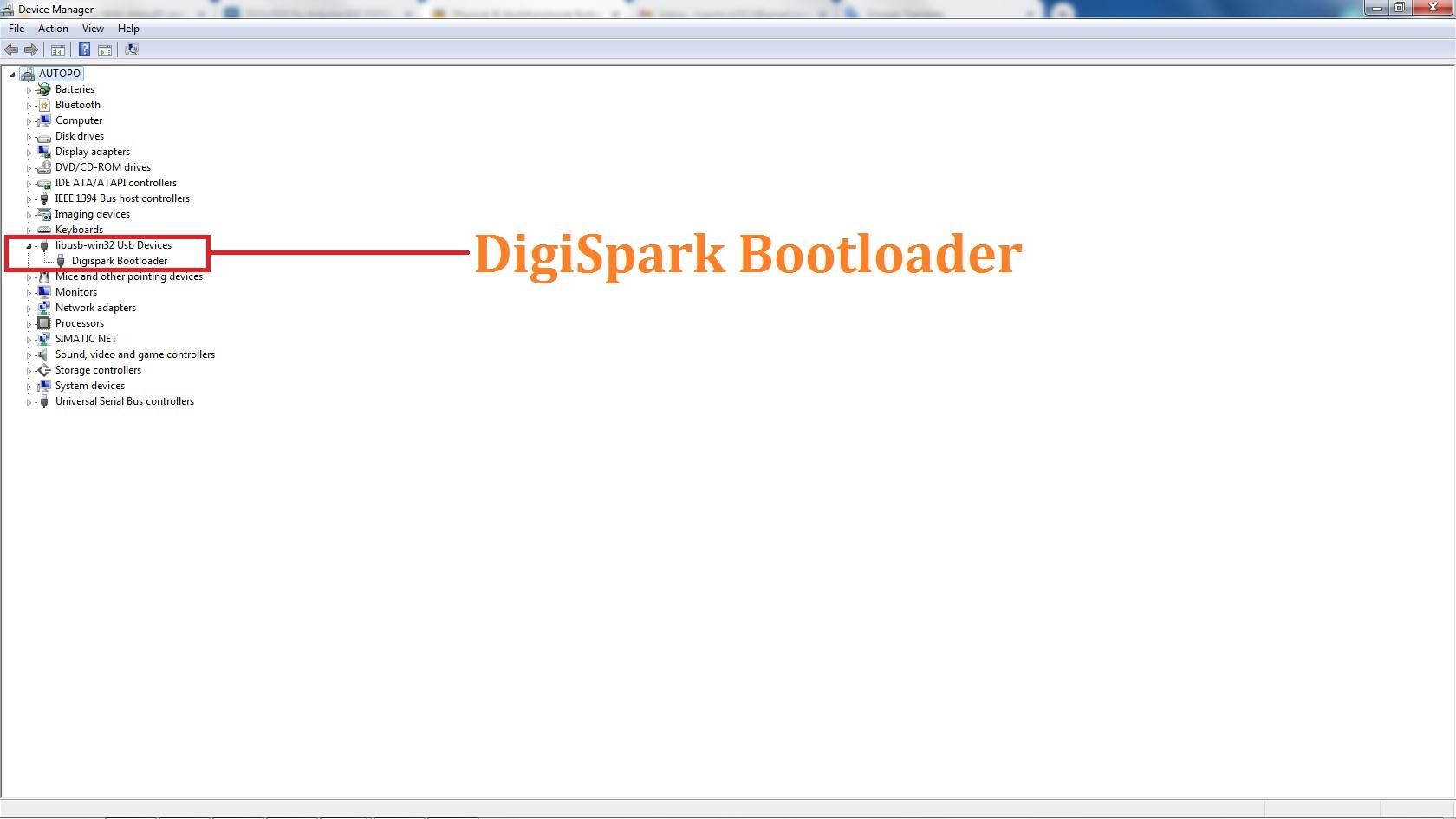

I have paid attention on "Device Manager" when I plugged the Attiny85 into my laptop.
Firstly, the Windows recognized Attiny85 as a "libusb-win32 Usb Devices" (DigiSpark Bootloader).
After that Attiny85 was recognized as a HID Devices (USB Input Device/ HID Keyboard Device/ HID-compliant mouse). The buttons are ready to be used.

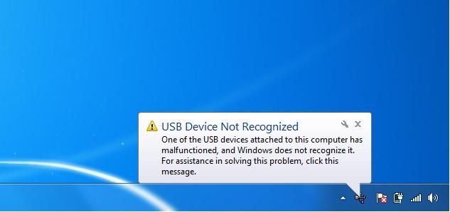

⦾ My laptop operating system is Window 7 SP1, before Attiny85 is plugged into my laptop I have to unplug my mouse, otherwise the error pop up "USB Device Not Recognized". And after laptop recognized Attiny85 as a HID device, I can plug my mouse again.
⦾ In case the "USB Device Not Recognized" error doesn't go away, I unplugg the Attiny85 and plugg it again. Then I press "HAND" button every time the laptop chime sound plays, it notify a peripheral device (Attiny85) is connected or disconnected from my computer. This is really effective way and Attiny85 can be regcognized as HID device instantly.

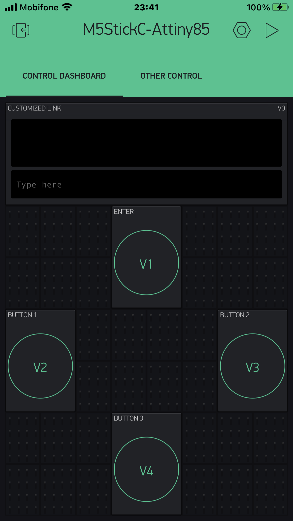

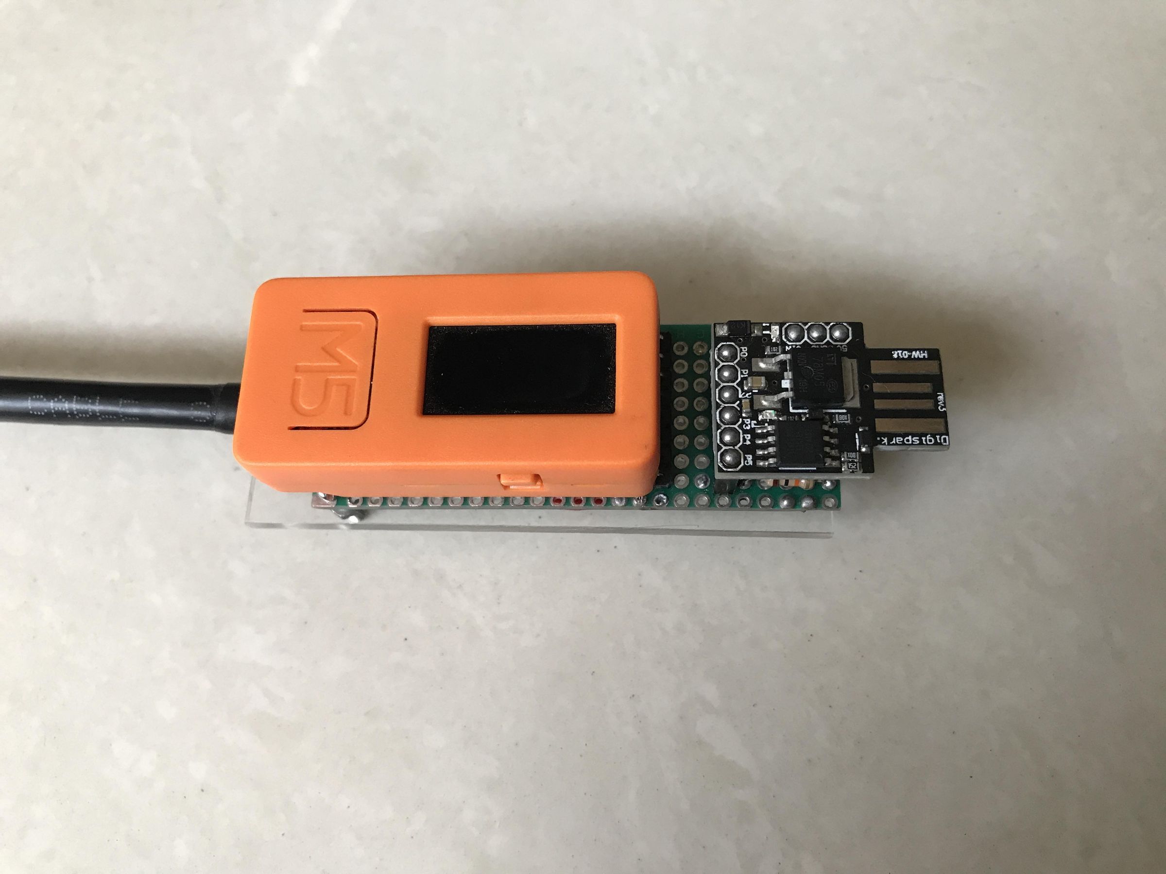

I can extend this push button box functionality with devices that communicate via I2C or SPI protocol. I have an 8-pin header available on the PCB for the M5StickC.
We can use the M5StickC screen to display the buttons states, and use some extra built-in buttons on it.
Or we can use M5StickC in combination with Blynk App. to assign and customize functionality to the push buttons and links we want to access, for examples:
