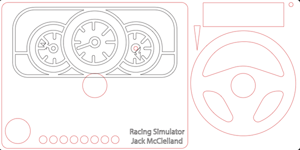

Step 1: Lasercut and Assemble the Frame ✂️
First, design and lasercut the materials for the frame. I designed this in Adobe Illustrator and went to my university's Maker Space to cut this out (they were super nice and helpful).
The frame here is made out of 1/8" dark purple acrylic. If I were to do this project again I would make sure the etchings are visible. You can't really tell in the picture or videos but I tried to engrave a heads-up display to make the project look a little cooler (it looks like a few dials / speedometers next to each other). I also engraved some text including my name on the bottom right that you also can't really see. The acrylic is so hard that it's hard to see this show up, and also I think the engrave settings on the lasercutter were a bit off. That's okay though – this wasn't the main point of the project.
Make sure you have a hole in the middle that you can use to run wires to the back from the steering wheel, and also attach an axle that you can mount the steering wheel on (I was going to get to this but didn't have enough time unfortunately). Also make sure you have a hole for the speedometer needle, and holes for any buttons you want to add at the bottom. Finally, there should also be a hole for the speaker. Remember to cut out the steering wheel and speedometer needle of course!
