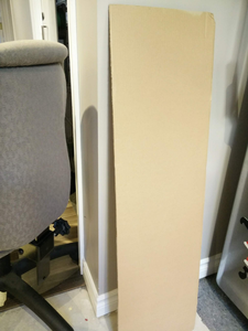

Step 1: Ramp
Find a ramp material. I used cardboard - maker's best friend. (this will allow multiple sizes of cars on the ramp) Could also use a car race track.
Educator Tip:
Want to try to have long single pieces so that students don't have to spend time making the ramp.

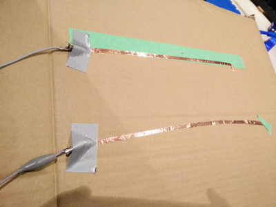

Step 2: Add Timing Steps
This step is to add the strips across the ramp and connect the alligator clips to them. Using multiple strips allows for a start and multiple distances and a stop option - could use the front side and the back side connectors for more timing function. Measure out the distance each strip is from the first strip - this will be used in your program and also in the analysis of your data.

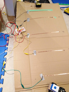

Step 3: Connect Them All Together
Clip the other ends of the alligator clips to the Makey Makey - might need to tape or clip in place on the edge.
In this example, I have a timing connection at start (at the green tape) and 10 cm, 30 cm, 50 cm and 70 cm.

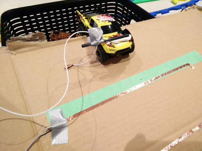

Step 4: Ground on the Car
Adding a long wire from the ground on the Makey Makey to the car and touching the ramp for each of the circuits to be complete.
