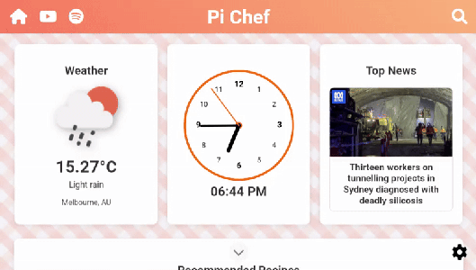

Introducing the Pi Chef, your latest tool in helping you cook!

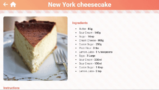

With the Raspberry Pi controlled display, you can easily browse recipes, set timers, view the weather and news and even enjoy high-quality audio music while cooking!
With a detachable display powered by its own battery and a base with speakers, a subwoofer, and a hidden amp, Pi Chef is the best tool in the kitchen!

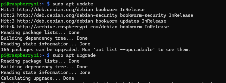

First, SSH into the Raspberry Pi and run
sudo apt update && sudo apt upgrade -y
This command:
  1. Fetches the latest package list (sudo apt update)
  2. Upgrades all installed packages (sudo apt upgrade -y)
This process may take a few minutes. Once finished, reboot the Raspberry Pi with:
sudo reboot

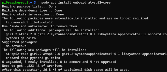

Since Pi Chef uses a touchscreen, we need a virtual keyboard to type when searching for recipes. The best option is Onboard, a lightweight virtual keyboard. Install it with:
sudo apt install onboard
Then, install AT-SPI2
sudo apt install at-spi2-core
Once installed, launch Onboard from the Raspberry Pi menu and then go to Preferences > Onboard. Then configure Onboard to auto-appear when selecting a text field (Enable "Auto-show when editing text"). You can also optionally adjust the keyboard theme and format to match the Pi Chef display.

Now, Pi Chef will automatically open on your Raspberry Pi on boot!
Step 15: Enjoy!
Congratulations! You’ve now successfully built and set up Pi Chef, your very own 3D-printed smart kitchen assistant! Now, you can find recipes, set timers, and enjoy music while cooking, all powered by your Raspberry Pi!
