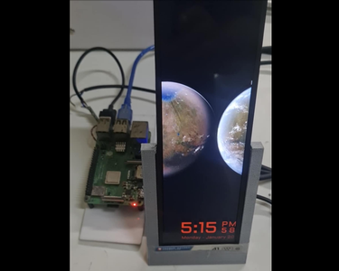

The Pi Digital Clock 7.84 inch Display is a digital clock that uses a 7.84inch display to show the time in a clear and easy-to-read digital

The Pi Digital Clock 7.84" Display is a sleek and modern digital clock featuring a 7.84-inch display for clear and easy-to-read time visualization. Designed for simplicity, it connects seamlessly with Raspberry Pi, providing reliable and efficient operation without the need for touch interaction. Perfect for desktops, wall mounting, or bedside use, it offers a straightforward and practical solution for timekeeping.

sudo apt update
sudo apt upgrade chromium-browser
chromium-browser --version
nano ~/.bashrc
if [ "$(tty)" == "/dev/tty1" ]; then
DISPLAY=:0 chromium-browser --app=http://www.clocktab.com --start-fullscreen &
fi
