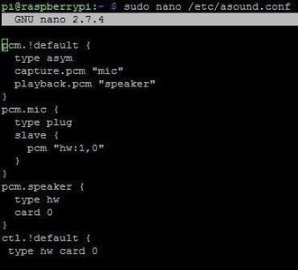

  • Now, we'll have to change the audio configs. To edit the asound.conf file, type the following command.
sudo nano /etc/asound.conf
  • Add below lines in the file. Then press Ctrl+X and after that Y to save the file.
pcm.!default {
  type asym
  capture.pcm "mic"
  playback.pcm "speaker"
pcm.mic {
  type plug
  slave {
    pcm "hw:1,0"
pcm.speaker {
  type hw
  card 0
ctl.!default {
 type hw card 0
This will set your external mic (pcm.mic) as the audio capture device (pcm!.default) and your inbuilt sound card (card 0) as the speaker device.
  • Create a new file named .asoundrc in the home directory (/home/pi) by issuing following command and paste above configurations (which were added in /etc/asound.conf file.) to this file.
sudo nano .asoundrc.

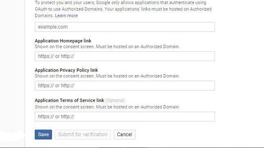

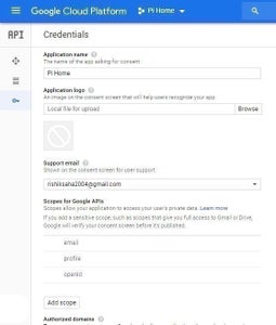

Step 6: Enabling the Google Assistant Cloud Project.

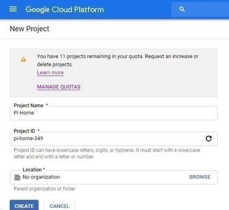

  • Open the Google Cloud Console and create a new project. (Name it anything.) The account with which you sign in will be used to send queries to Google Assistant and get your personalized response.

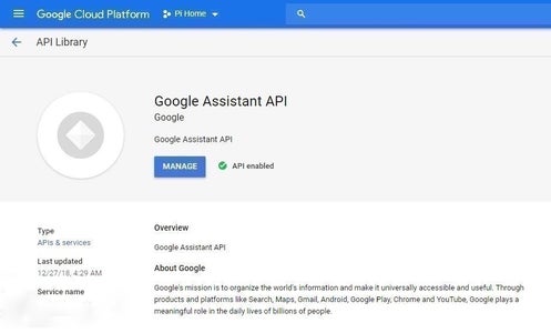

  • Head over to API manager and enable the Google Assistant API.
  • Make sure that you enable Web & App Activity, Device Information and Voice & Audio Activity in Activity Controls for the account.

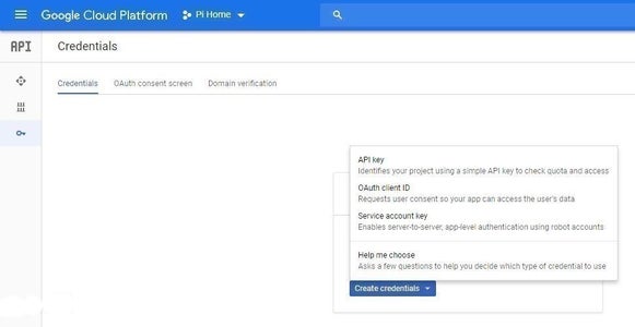

  • Go to “Credentials" and set up OAuth Content Screen.

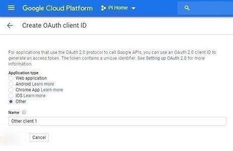

  • Go to “Credentials” tab and Create new OAuth client ID
  • Select application type as “Other” and give the name of the key.
  • Download the JSON file that stores the OAuth key information and keep it saved.

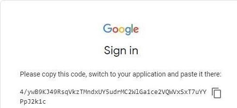

Step 7: Authenticating the Raspberry Pi
  • Install authorization tool by running below command.
(env) python -m pip install --upgrade google-auth-oauthlib[tool]
  • Run the tool by running following command. Make sure you provide correct path for the JSON file you downloaded in step 6.
(env) google-oauthlib-tool --client-secrets "JSON_FILE_PATH" --scope https://www.googleapis.com/auth/assistant-sdk-prototype --save --headless
  • It should display as shown below. Copy the URL and paste it into a browser. If instead, it displays:
InvalidGrantError
then an invalid code was entered. Try again.
Please go to this URL: https://...
Enter the authorization code:

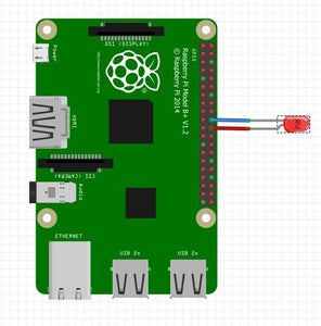

Step 8: Setting Up the LED Indicator.
  • Connect your LED between GPIO pin 25 and ground.
  • We are going to set the GPIO pin 25 as the output pin.

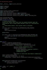

  • Google Assistant SDK provides a callback EventType.ON_CONVERSATION_TURN_STARTED when the conversion with the Google Assistant begins. At that point, we are going to set the GPIO 25 to glow the LED.
  • Whenever the conversation terminates EventType.ON_CONVERSATION_TURN_FINISHED callback will be received. At that point, we will reset the GPIO 25 to turn off the LED.

  • Run the steps one by one. Go to the user directory. Create new python file main.py.
cd /home/pi
sudo nano main.py
