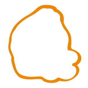

Step 5: Creating Your Cookie Cutter Edge
Next the cookie cutter's edge needs to be designed.
Click on the Stamp Back layer. From the option list that apears, select Set as Reference. Create a new layer above the Stamp Back layer. Set the color to a new high contrast color. I used orange. Make sure that Paint Inside is turned on. Setting a reference and turning paint inside on will allow the Stamp Back layer to act as a stencil, preventing the area the Stamp Back layer covers from being drawn on. Loosely outline the Stamp Back layer. Download the cookie cutter edge PNG file.

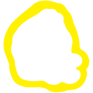

Step 6: Creating Your Cookie Cutter Handle
To make the cookie cutter easier to use, a handle can be added.
Click on the Cookie Cutter Edge layer. From the option list that apears, select Set as Reference. Create a new layer below the Cookie Cutter Edge layer. Set the color to a new high contrast color. I used yellow. Select the paint bucket tool and click inside the Cookie Cutter Edge shape. This will allow the handle to sit above the cookie cutter's edge on the final cookie cutter. Make sure that Paint Inside is turned on. Select the pen tool. Loosely outline the Cookie Cutter Edge layer to your desired handle thicknes. Download the cookie cutter handle PNG file.
