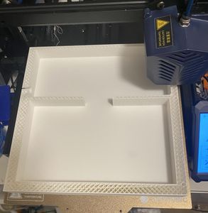

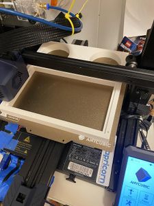

Step 2: 3D Printing
I put converted the f3d files into Stl's and uploaded them to Cura Slicer. I then uploaded the Gcode to my printer via Octoprint.
I was having trouble getting the first layer to turn out properly and was having lots of trouble calibrating the printer. Once I had finally gotten the printer calibrated I decided to replace the nozzle with a better quality one, this fixed all of my problems and I was able to print the pieces.
After that I pressed print on the top half and waited for about a day and a half. The print turned out great and I quickly pressed print on the second half. The second half also turned out great and took two days.
