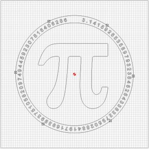

Step 2: Pi_pad_front Gcode Preparation
Import the Pi_pad_front vector graphics into your CNC prep softare. I use CarbideCreate for my Shapeoko router. I find it easiest to set the origin (0, 0) at the center of the circular shape.
Select the "Pi symbol" and the "inner circle". Program to cut just over half the depth of the wood (.390") using a .25" diameter flat bit. Next select the "outer circle" and program to cut full depth, leaving tabs to hold keep the PiPad attached. Save this gcode.
Next select all of the small perimeter numbers "3.1415....." for engraving. Select a Vee-bit cutter and perform an engraving operation. Save this gcode separately.

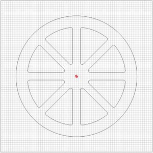

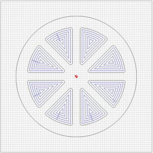

Step 3: Pi_pad_back Gcode Preparation
Start a new CNC program. Import the Pi_pad_back vector file. Again, I find it easiest to set the origin (0, 0) at the center of the circular shape. Select the pie triangles. Program to cut just over half the stock thickness (.390") using a .25" diameter flat bit. Save this gcode.

Step 5: Run the V-bit Engraving Gcode
Step 6: Run the Front_pi Carving Gcode
Replace the v-bit with the .25" flat bit. Re-zero the 'z' depth. Run the gcode.
Step 7: Carve the Pi Pad Back Side
Unclamp, flip the workpiece, and re-clamp. Re-zero at the center of the Pi pad. Run the back side gcode to carve out the pie triangles.
