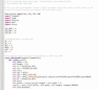

Step 7: Game Code #1
This shows the start of the program
Step 8: Game Code #2
Here are 3 helper routines:
wait_shake() this waits until the sensor registers that the circuit is being shaken. SQRT(x*x + y*y + z*z) provides a value from the 3 accelerator readings to register how much the circuit is moving about.
colour(R,G,B) converts 3 byte colours to 2 byte colours (RGB565) for the display screen.
ctext(text,y,c) centres a text string on a screen line.
The next few line start the display and the accelerometer

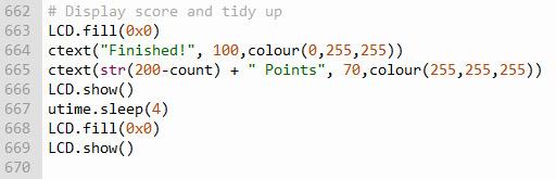

Step 10: Game Code #4
This displays the score turns off the screen.
