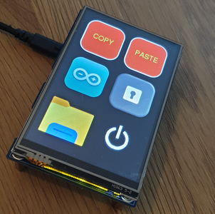

Turn your Raspberry Pi Pico into a USB-HID device with a touchscreen interface! In this project, we’ll set up the programming environment in the Arduino IDE, configure libraries for the 3.5" Pico Touch LCD shield, test basic functionality, create simple buttons (for copy & paste), display custom icons, and even use Windows environment variables to launch programs.

You now have a fully-functional Raspberry Pi Pico + Touchscreen Shield that:
  1. Displays graphics and icons.
  2. Acts as a USB HID keyboard.
  3. Can map touchscreen presses to Windows shortcuts, environment variables, and commands.
