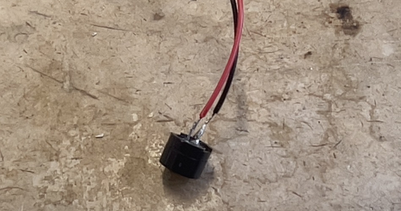

Step 5: Buzzer Wires
Connect both anode and ground wires to buzzer
