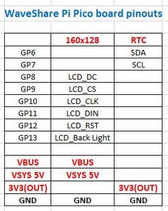

Step 1: Connecting Up the Devices
This was very simple; I just pushed the three boards onto the Pimoroni Pico Decker and plugged in the USB cable.
Step 2:
If you do not have a Pico Decker, or similar board use the connections shown above.

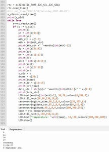

Check the time being displayed is close to the correct time.
Step 5: ​Looking at the Project
The video shows how the project works. On running the program the Pico waits until the second value changes in the the RTC. It then extracts the full date, time and temperature values and displays them on the screen. Two type faces are used, the built in Framebuf font and Les Wright's defined font in different sizes. The full code is available below.

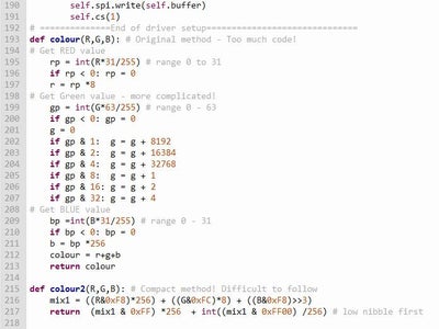

Step 6: Improvement to Colour Setting Routine
My first try at this, colour(R,G,B) worked properly but looks pretty terrible. I've done some more thinking and produced a neater looking version, colour2(R,G,B). Either work and should produce the same outcomes

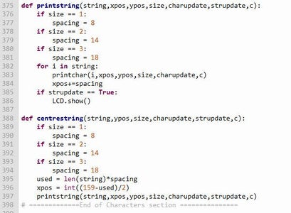

Step 7: Centred Text
As the number of letters in the weekdays and month names vary in length we need a routine to centre these lines.

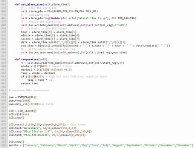

Step 8: RTC Code From WaveShare - Part 1
This should the start of the Waveshare code, I2C and register setup, sett a new RTC time and reading the current time.
Step 9: RTC Code From WaveShare - Part 2
Setting up and alarm - which I have not yet used and my code to read the temperature from 2 registers with INTEGER value not BCD!
Step 10: The MAIN Loop
Reading the values and sending them to the display screen.
