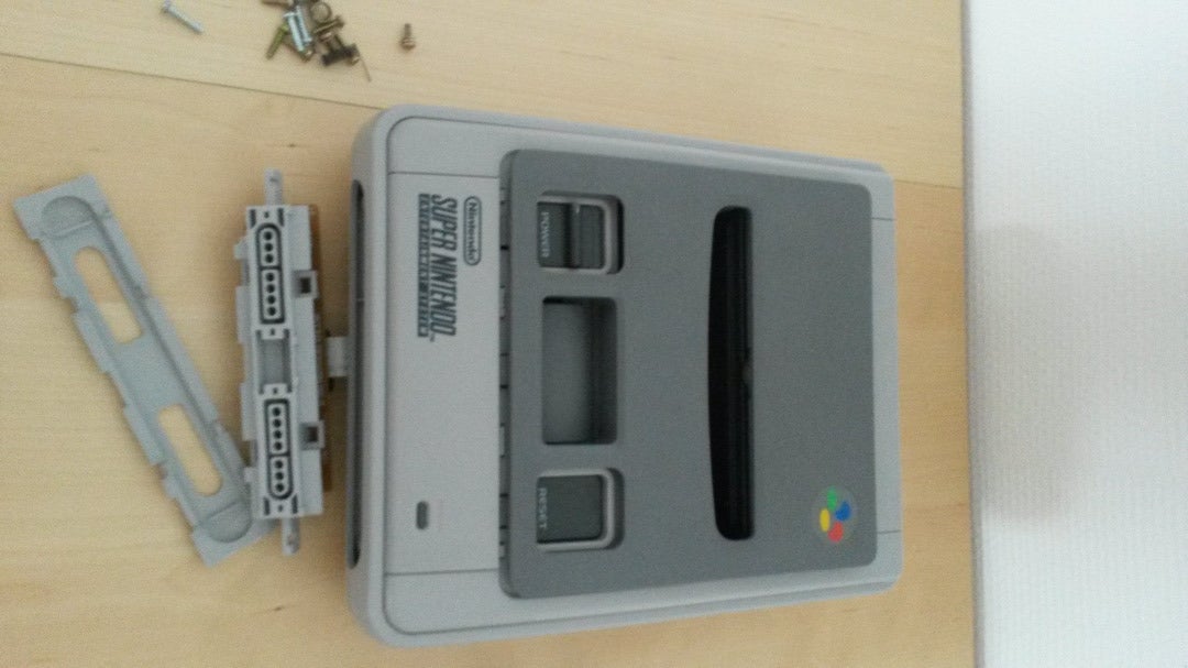

I purchased an old non functional SNES and decided to put a Raspberry Pi inside to transform it into a retro-gaming emulator. The project is simple: graft a new heart to an "out-of-order" SNES. In order to modernize the controllers to play with other consoles and minimize the SNES destruction, I 3D-printed a new front panel. This making didn't require many electronic or computer skills. It 's more like a lego building.

The first step is to take the SNES apart and to cut all the unnecessary stuff inside in order to make some space.

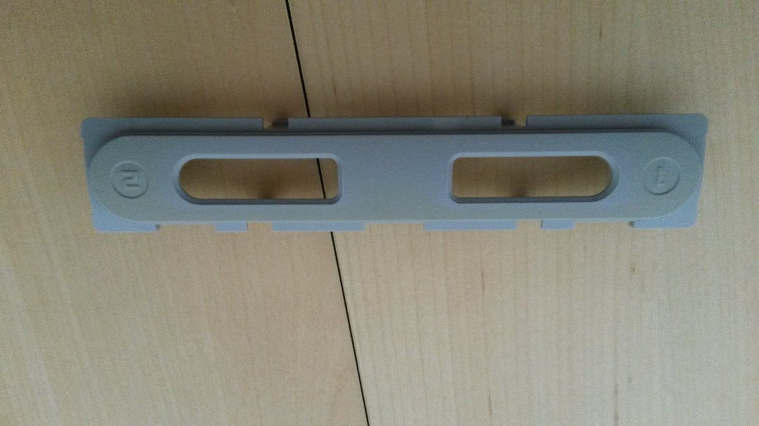

Then I reproduced a more simple front panel on Sketchup and placed two USB connectors instead of the normal ones. I printed the piece on a friend's 3D-printer, removed the plastic needed to print correctly and fixed the USB connectors.
Finally, I tested the piece in place.
